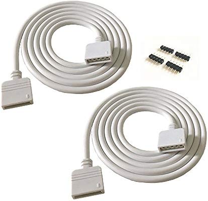

Hello! And welcome to Hubitat. Sengled doesn't sell one specifically but the strips use a standard 5 pin connector on the end of them. So, you should be able to use a standard extension cable, like this one:
I know @ogiewon has these strips. Maybe he would be so good as to confirm if he things these would fix the Sengled header pins.
I have not used any extender cables with these strips. Wish I could add something to the conversation...
What are the size of the header pins on the end of the strip? Are they standard size, separation? Do they look like they would fit with the cable I linked to?

I don't see that in the listing. But a cable is a cable. 24v would not require any larger a cable for that short a distance than 12v would. But it's up to you. Best of luck.
I just measured the connector. The five pins are evenly spaced across a total of 1 centimeter. So that would mean 2.5mm spacing.
