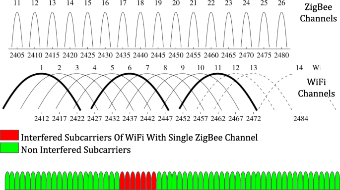

Make sure your wifi is on channel 6 or below and that your zigbee channel on 25.
Interesting, I would start with any interference in your home and other wireless. I chose Channel 20 for Zigbee because it sits between 6 and 11 nicely:

Thanks for the suggestion, I had it on 20 based on other threads recommending it, and put it on 25 yesterday. Regardless, most of my WiFi devices work on 5Ghz, I only have just 3 or 4 on 2.4Ghz, so on that end I didn't see anything that busy and 2.4Ghz wifi is on channel 6.

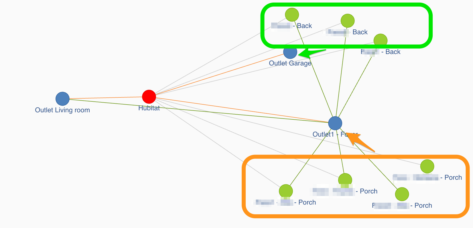

I rebuilt the network and got pretty bad, with all light bulbs connected to one of the repeaters(outlets), some of them even far away from the outlet, and in between 3 walls and still picked that outlet. Today looks like they picked another outlet, but same thing happened even the ones further away picked the same outlet. And again most light bulbs are not reachable again. Here's the visualization(based on proximity, attenuation, etc, Porch light bulbs should be all on Foyer Outlet, and Back light bulbs should be all on Garage Outlet).

BTW here's how the network is looking right now(I got promoted just now to upload images):
