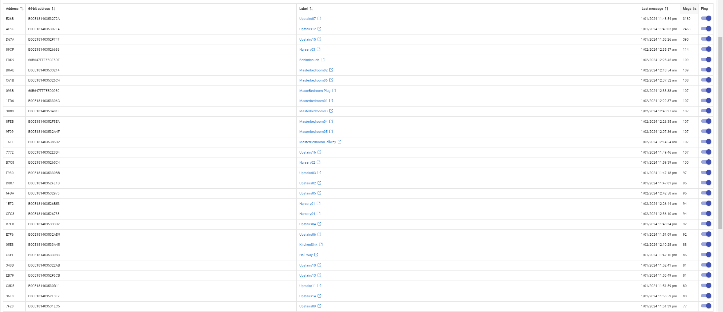

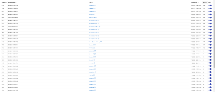

I've had on and off issues for years with these and I'm trying to give it one college try to get everything actually working correctly. For instance I have two bulbs in the group that turn on and off fine but They do not respond to commands individually groups and scenes or I rule automations don't seem to work correctly. I have a bunch of repeaters in my network and my table looks pretty good for Zigbee network i think

Only see three repeaters talking to your hub and the displayed LQI's are not all that great.
  • LQI: Link quality indication (an assessment of link/hop quality); higher is better (255 is best)
What model and how many repeaters are you using?
