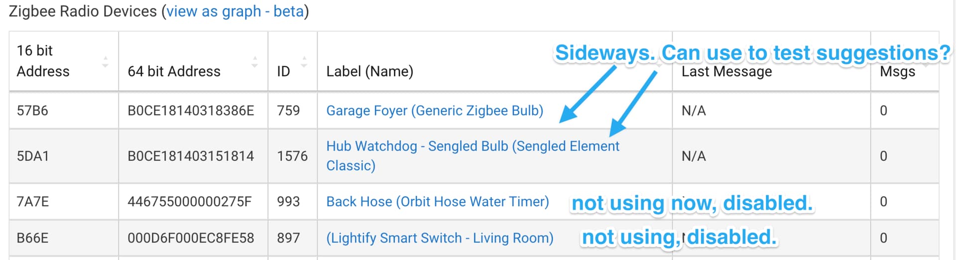

I'm at a loss for why my Sengleds (some element classic, some element color plus) randomly drop off. It typically happens during a power outage, some of them turn on and stay on, some don't turn on, sometimes they won't come back at all unless I either physically remove power and put it back, and even sometimes it requires them to be reset (off/on enough times quickly that my wife asks me wtf I'm doing while adding zigbee devices).
I've tried experimenting with classic drivers for both, and have noticed NO difference. I wish there was a rhyme or reason to why they don't consistently come on - it's not even consistently the same style that has issues - this morning I had 2 classics, 4 plus out of total of 12 bulbs sideways. No power outage last night/this morning, no hub reboot since 7/15.

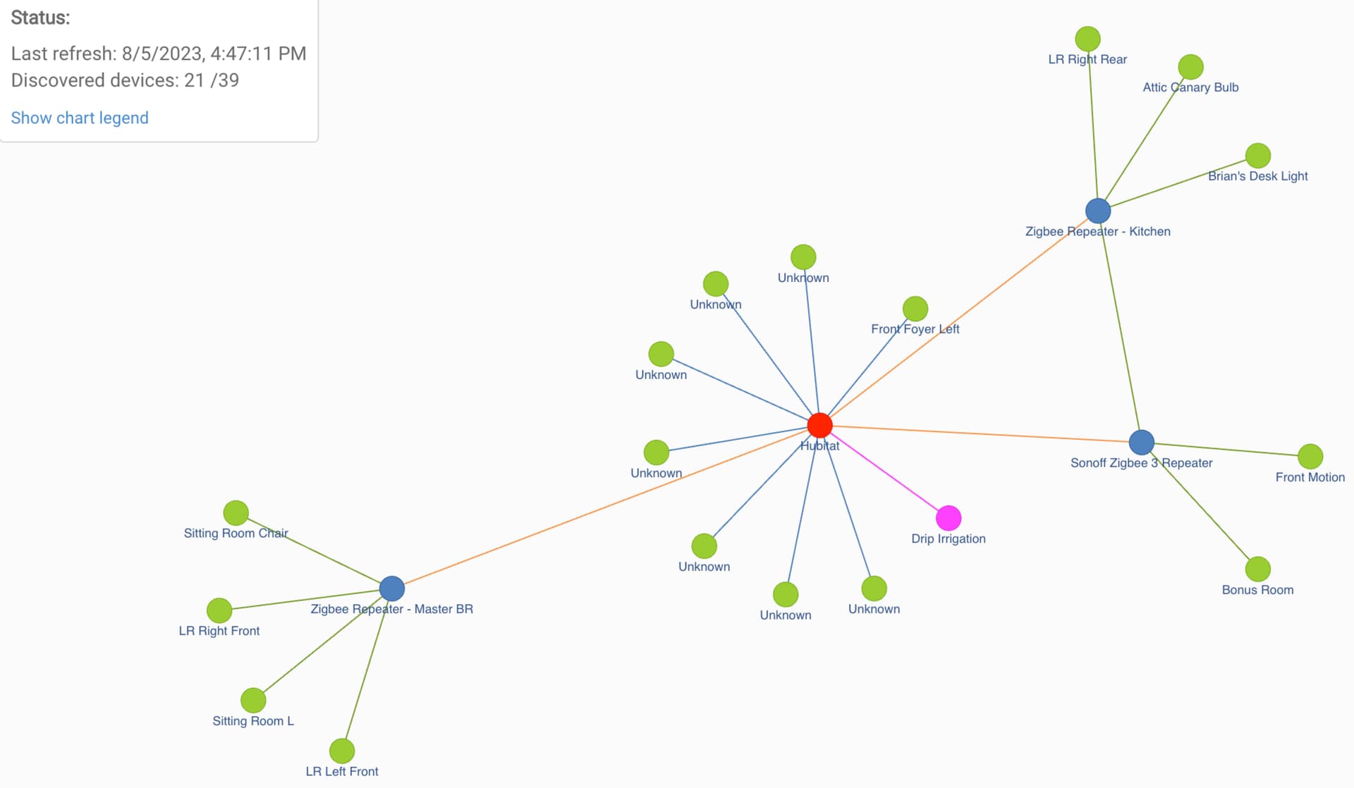

  3. I don't think it's my zigbee mesh as my only repeaters are 2 of the little Tuya USB devices and one is a Sonoff one with an antenna.

Only zero msg devices - so I have two bulbs that are messed up and will require physical powering off, or resetting.
I would think adding some more repeaters would strengthen your mesh. ZigBee is a mesh architecture after all. The way your network is constrained it looks like a star network topology. Those three repeaters are all choke points for the inrush of messages when power resumes. If you had multiple routes, the network would be more resilient.
Certainly not discounting the "more repeaters the better", but if I replaced them all and had a single hue hub, supposedly, they'd all work fine off of that single hub.
Hue isn't straight ZigBee, they bake in their own resiliency features. If you can afford to use all Hue, bulbs you can replace the Sengled bulbs, problem solved. If you can't you might want to add a few repeating devices. I fixed my ceiling fan woes by adding a ZigBee power wallwart in those rooms.
