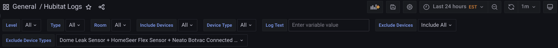

In my Grafana dashboard I have these filters:
I have drop-downs for both devices/device types to include and devices/device types to exclude. I exclude a bunch of chatty device types by default.
