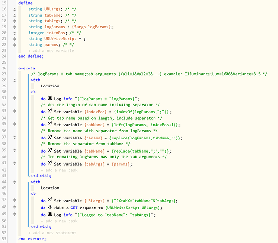

I use this virtual device to send my logs. It has attributes to enter the URIs of the app scripts in the sheet.
It uses this format:
Set up the logParams with the data by making a string.
logParams = "Variable Name 1="variableName1+"Variable Name 2="+variableName2 ...
Then I set the sendLog attribute using the logParams string:
googleLogs.sendLog("Sheet Name", logParams)
Inside the code for the log device, there is an array built in the code that has to be manually modified for deletes, you just add entries to it in the format:
"sheet=Sheet Name&days=7" -> to keep 7 days worth of data on the sheet. It will randomly delete the rows down to the proper number of retention days for sheets added to the array.
I left my sheets in the code as an example of setting up the delete array in the code.
Edit: Note, this is a bit of a manual and hacky way to do it, and though I'm posting code this is not a release or anything, but if you want to try and use what I posted I'm happy to help you get it working.

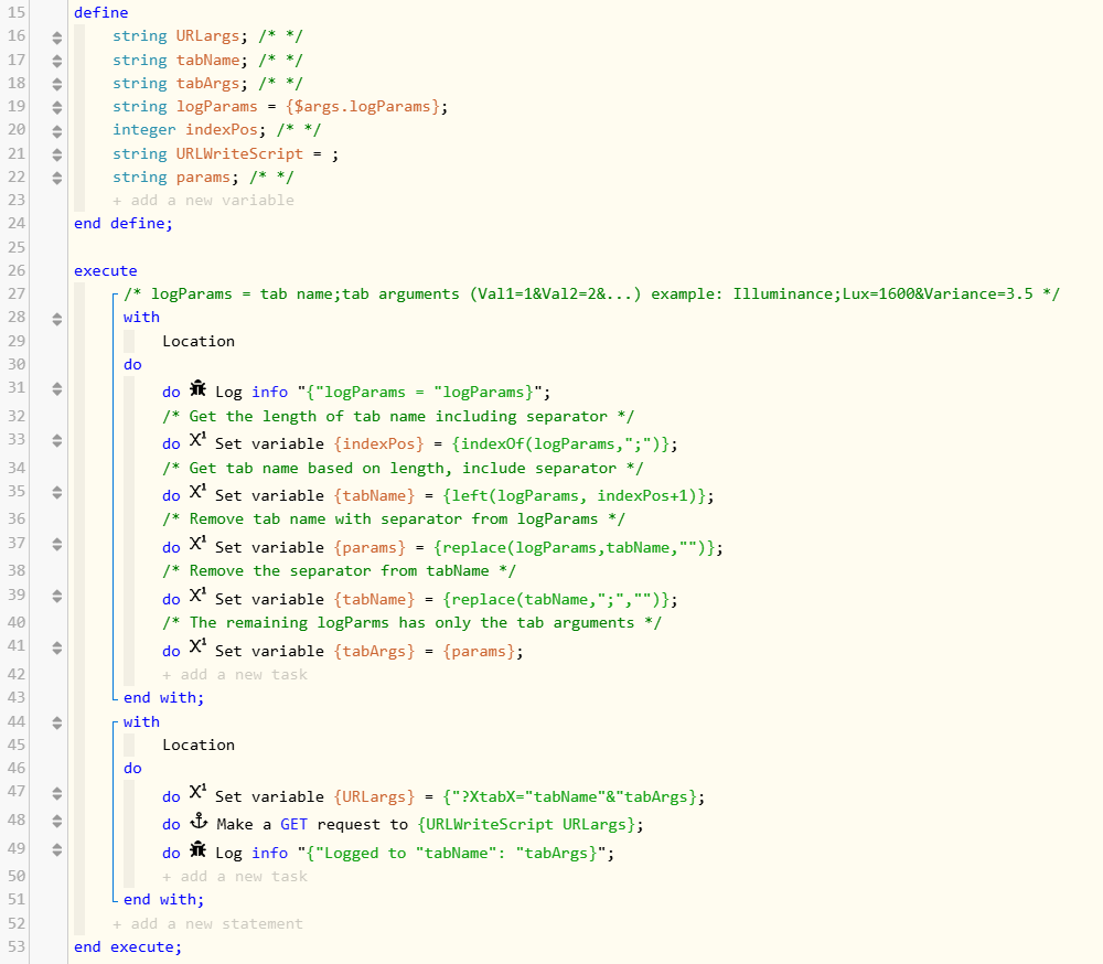

I also wrote a script later to pull from a Google sheet, I forgot about that but it is mentioned in the above post. I stopped using it, but I had it working for a bit to send data to a sheet, have the sheet calculate new values, and then I would get the new values back from the cells in the sheet. It was a roundabout way to do some more complex calculations when I was using Webcore.
I just found the piston I used to use. logParms is an argument, and I would send data to it from other pistons for logging.
