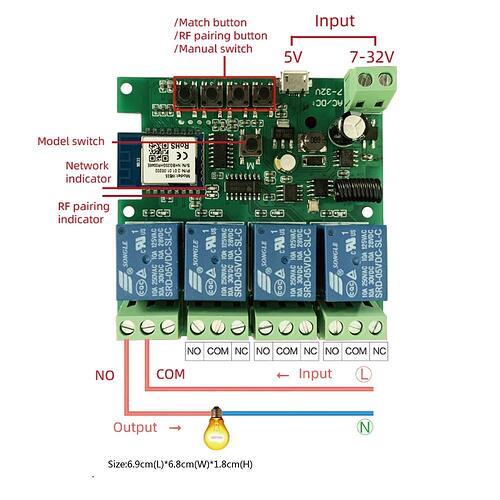

The MHCOZY 4 channels 12V works well too with the same driver

But OP should be forewarned that these MHCOZY devices have evolved, the 1 & 2 ch ones sold in cases are of a different generation than the "bare cards" first sold, and the built in driver does not always work correctly as it use to with these...thus the benefit of the above mentioned Community Driver.
