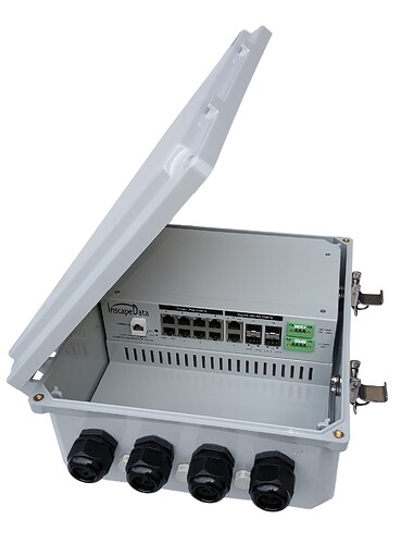

If you insist on running external, you could get something like this. Placed up high you wouldn't really worry too much about a lock though I'm sure a shackle could be added. You will also need to add power to where ever you mount it.
