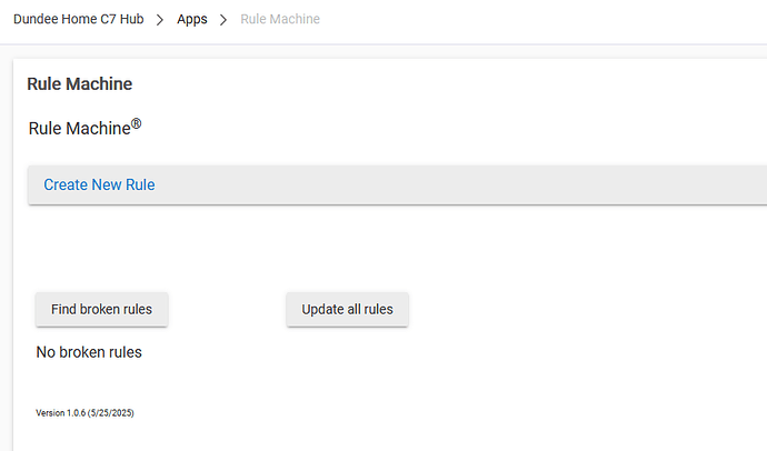

Searching in a rule. I have a rule that set a thermostat to 65, and I want to search for '65'. It'd be nice if there was a search button here:
