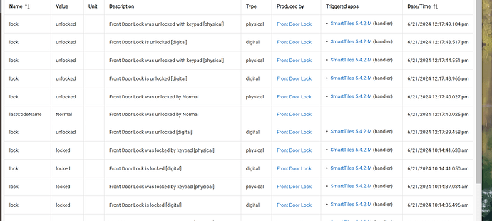

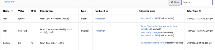

Interesting...my Schlage Z-Wave (non-Plus) does not generate duplicate (or triplicate) events...I just unlocked and locked front door manually, and get one event for each action in logs:

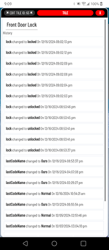

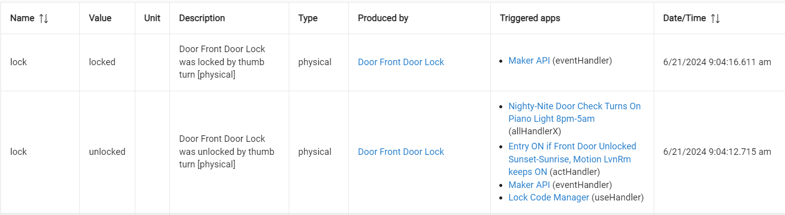

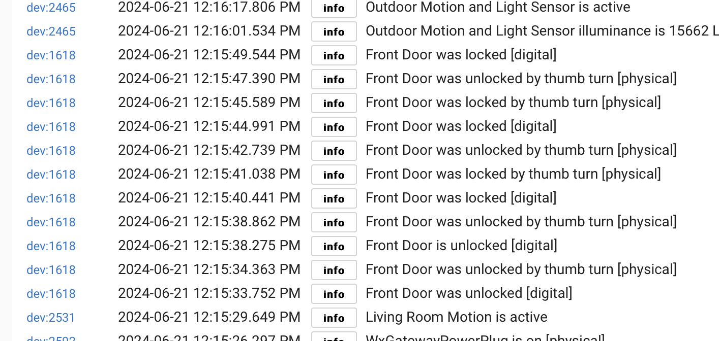

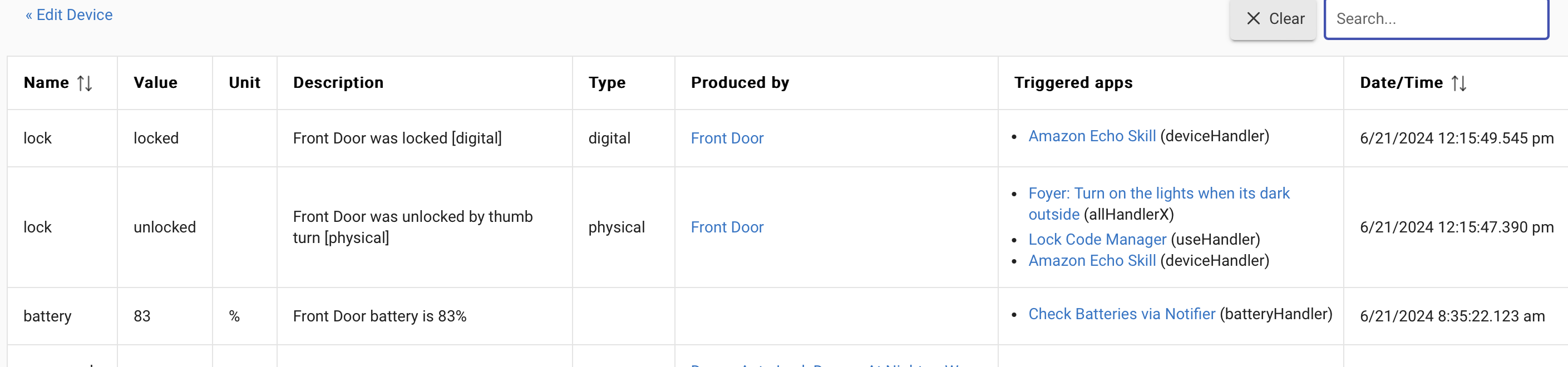

Thanks Jeff. Sure. I went to the front door which was locked. I unlocked it. Counted to 5. Then locked it again. Results:
Events
Logs
On iPhone
So you get one event for each "event". Three log entries and three HK Alerts.
Interesting, yours is wavering. I wonder if your lock is having a hard time getting acks back from the hub so it is sending the events multiple times.
The alternating events must post quickly and send to Apple HK before the hub cleans it up and shows you just the one event or something, I have not seen that before. There is no other explanation because only the actual events get forwarded.

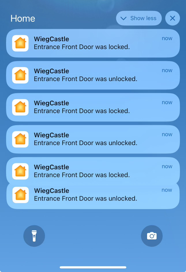

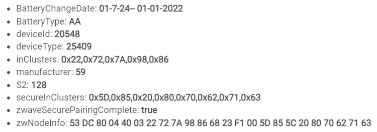

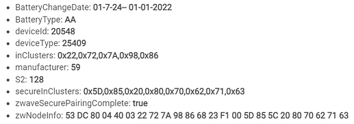

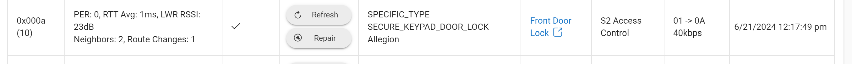

It's a Z-Wave Plus version, forget the firmware version. My original non-Plus lock died and they replaced it with a plus version. The lock is about 12 feet from my 8Pro hub with a Aeotec Range Extender 7 in between. Sigh. At least it works reliably. I just have to put up with my wife saying "Why is your phone going nuts?!"

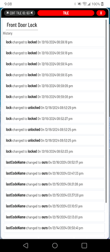

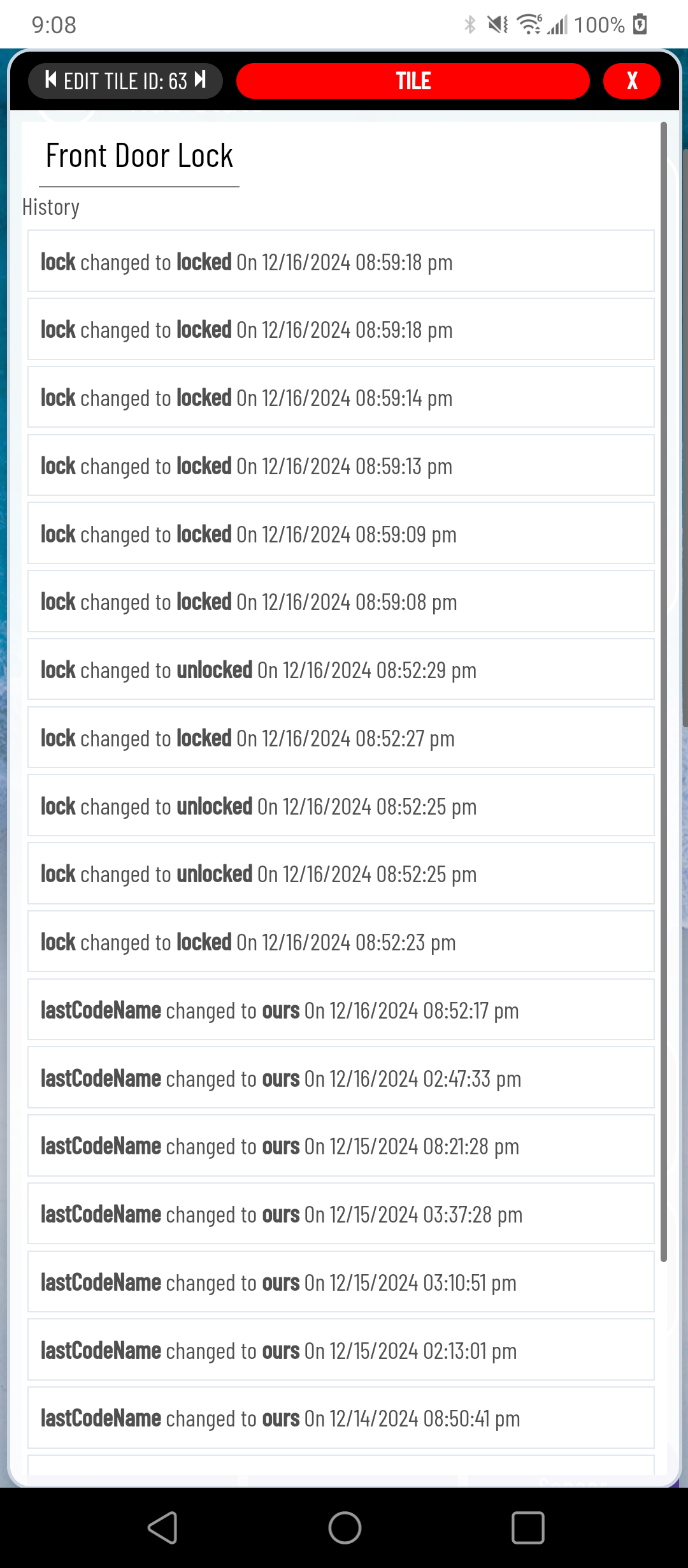

Oh and it's one of two BE469 locks and both of them do this. Wish they didn't. When the wife unlocks and locks both of them I get 12 rapid succession notifications. That's super duper fun. These locks are the only thing I get repeated notifications on iOS.
from reading yours i assume you got two log entries as there are different events.. that is not the same as 3 of the same event in the log which in this driver ssems to generate 3 separate events
here is the other lock same exact pattern

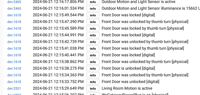

Hi @jtp10181 i was wo dering if you had managed to investigate this further? Ive been noticing duplicate notifications as well. I thought inhad a buggered or duplicate automation setups, but now that i look im showing duplicate events as well.
My 2 locks the same ... not waivering . Multiple lock/unlock (4-6) for every event. Happens to 2 locks in different hubs. Ive just been ignoring it.

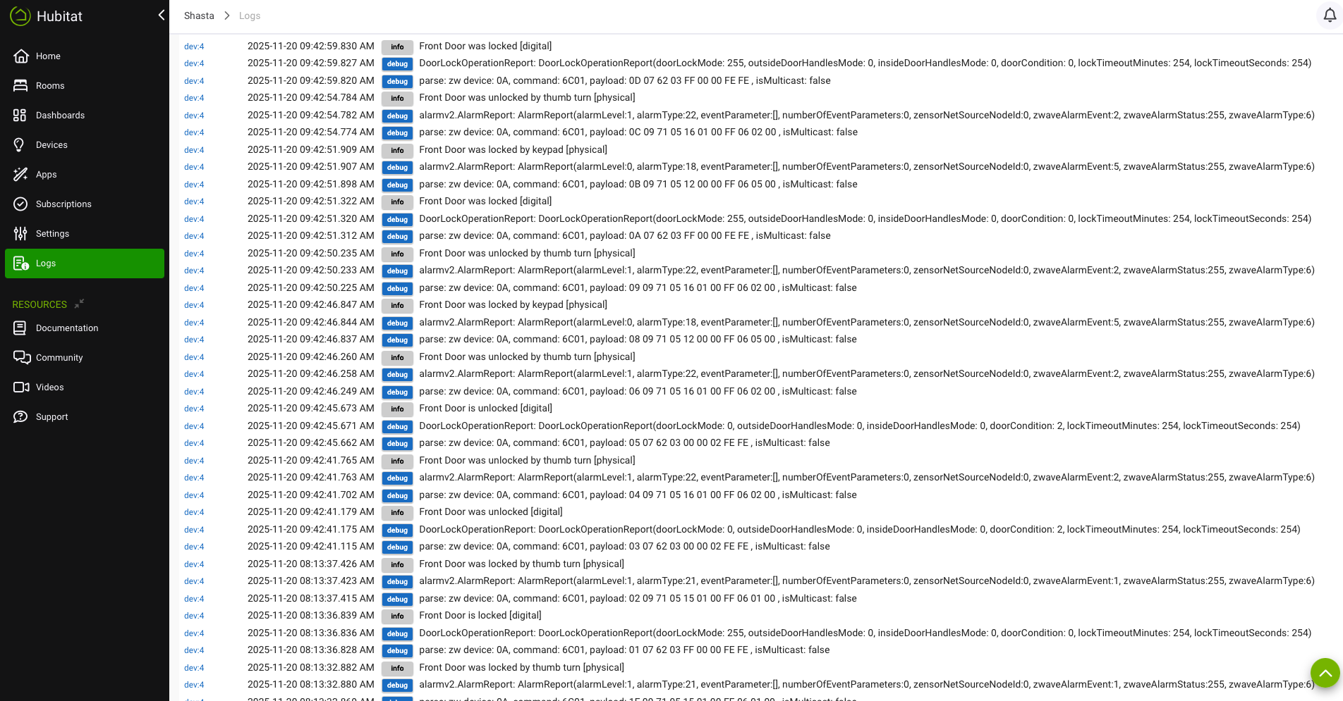

My Schlage BE469 Lock recently began doing this. It has been working fine for months and suddenly began getting the multiple notifications.
Tried updating my Hub to 2.4.3.158 but the issue still remains.
