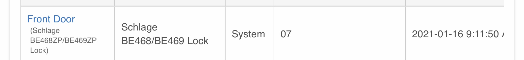

You have a bad pairing or (perhaps, unlikely) a weak mesh. I have a C-7 now running 2.2.4.158, and I have 2 BE469ZP locks. One has 0.11.0 firmware, one has 0.10.9. Both paired and were detected for the built-in ā€œSchlage BE468/BE469 Lockā€ driver. Both report the battery correctly. Both work perfectly. Both have Ring Alarm Range Extender v2 devices about 5 feet away.
Screenshot

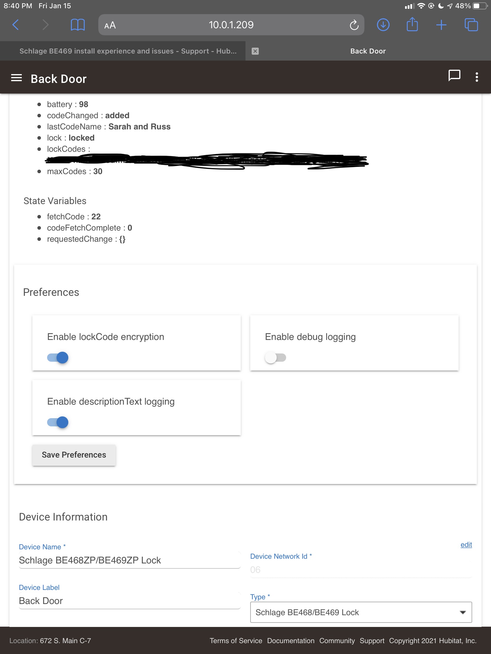

Well, I gave an existence proof screenshot above showing that battery status does report on my two BE469ZP locks. Battery status was also reported when the locks had BE469NX electronics, prior to swapping out those electronics.
Never heard of that Hubitat version, so I can’t guess why your locks don’t report battery status. I don’t see that you have reported the firmware you are running, perhaps that is the issue.
My Schlage locks (previously, both BE469NX, now, both BE469ZP) have always reported battery status on every firmware version for the C-5 beginning May 2020, when I got my C-5 and moved from Wink, and on every firmware version for my C-7 since I got it in August and moved everything over in September, now running 2.2.4.158.

Ok. Does your pairing (cluster info) match mine? That’s what determines battery reporting. Here’s what I’ve got:
There’s got to be a reason you aren’t seeing battery status. The driver does work with your configuration if the mesh is good.
