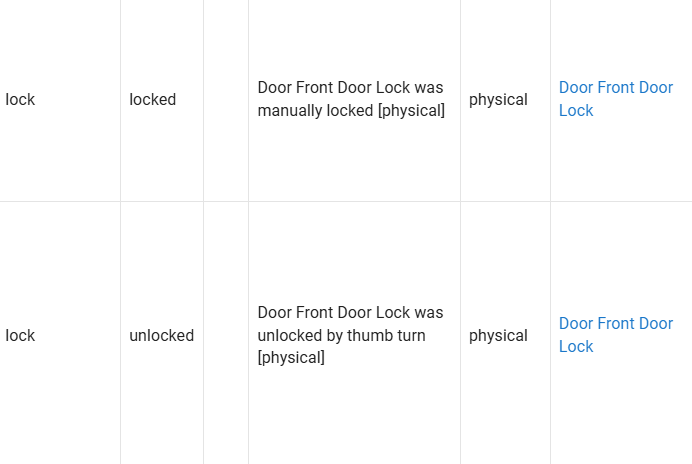

On my BE469 (original Z-Wave) on Z-WaveJS I do get separate physical and digital lock events, but I am getting duplicate events on digital lock/unlock.

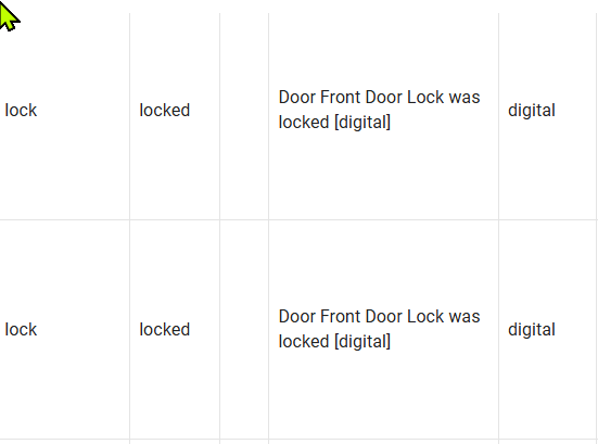

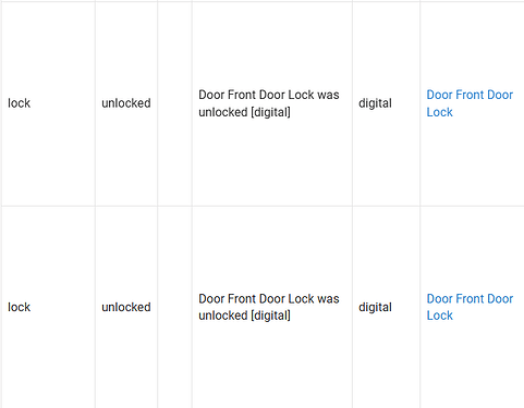

Duplicate digitial lock/unlock events:
Sounds like old Z-Wave driver tricks for devices that don't always report.. A Get sent after a Set..
I'll check the driver's duplicate event filtering.. Which driver are you using @danabw

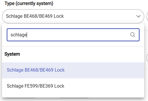

Try the DT Z-wave lock driver...
Thanks, but the dupe notifications don't affect any of my automations negatively, so they haven't been an issue. The built-in driver has been rock solid for me since I moved to HE so I'm going to sit tight. :slight_smile:
The DT driver is a built-in driver, I think it is new-ish?
Thanks…my better half is coming home from a trip tonight and let’s just say she won’t even use Siri…so I think I’ll wait a couple days to try changing over
Yeah, that's true, the DT drivers are built in, but since the Schlage driver is working for my uses, I just don't have any need to experiment. :man_shrugging: :slightly_smiling_face:
All the DT drivers (I believe DT stands for device type) query the device over z-wave to determine supported command classes and settings. Based on that they adjust the preferences/commands shown on the device page.
I was under the impression they were preferred for 700/800 series devices but not older devices.
Maybe @bcopeland or @bertabcd1234 can clarify/correct what I've written.
That sounds familiar, I think you have it right.
My locks are definitely the older non-plus version Schlage. That driver seems to work fine, maybe better than the dedicated Schlage driver, at least on JS Z-wave.
I am not sure if it is a coincidence, or whether the driver is generic enough to work without errors on JS, or what.
I have been on this driver for maybe a month now, without any apparent issue, except the known lock code issues that affected everyone on JS.
In theory it should work for any device of that type.. But it doesn't do much for older devices.. Newer devices it will actually pull the config parameter info from the device.
