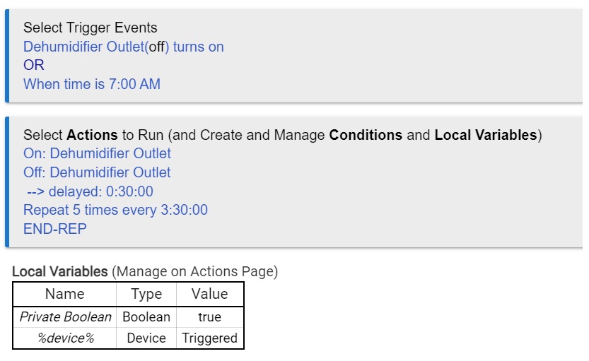

The darn appliance runs almost constantly even when set to its highest humidity level. I thought I could write a rule or automation that allows it to run for a half hour, every 4 hours. That is, 30 minutes ON followed by 3 hours and 30 minutes OFF. With a start time of 7AM so I hear it come on. Bonus points for sending a notification to my phone.
I've tried multiple iterations. A Basic Rule with times laid out caused it to come on at 0700, but it then ran again at 1120, 1520, 1920, 2320, 0320 but then it reset back to ON at 0700. This was despite having 3hrs30min specified between ON events. This drove me nuts so I deleted it out of spite...
I tried a Rule Machine that turned the outlet on at 0700 or when the switch was turned on. This is my second try at it and it hasn't worked. The Repeat doesn't bring it back to the On command, instead repeating a delay of 30min and then turning the outlet off.
What approach should I take to solve this? It is highly likely that I just don't understand how to set it up correctly. Your time and help are appreciated as I learn my way through this.
Your repeat is malformed. The actions between "Repeat x times every y" and "END-REP" is what gets repeated. For you, that's nothing. :smiley: See the docs for various examples of repeats. In your case, it seems like you could get what you want by putting your "On" and "Off" actions inside that block.
That makes so much sense it has to be exactly what I was doing wrong…! Thanks. I will implement it later today when I have time.
