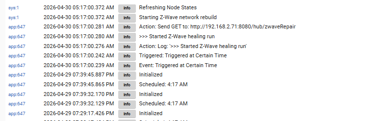

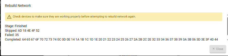

I have been sorting out some long standing ZWave issues on one of my networks. As a test I thought I would schedule a network heal (zwaveRepair, Network rebuild as it is called in different locations).
From the log it appears the rule triggered properly and the HTTP call triggered the initiation of the repair run. I was surprised there wasn't an entry upon the completion of the run?! Does that mean the zwaveRepair never competed or that there just isn't a log entry for completion?

OK the plot thickens.....
When you run the repair manually you don't get a start or complete message in the logs!?!
So if you start it via http command you get a log entry for started but not one for completed. If you run the repai manually you get zero log entries....
Seems this would warrant a token message to the log and timestamp.
