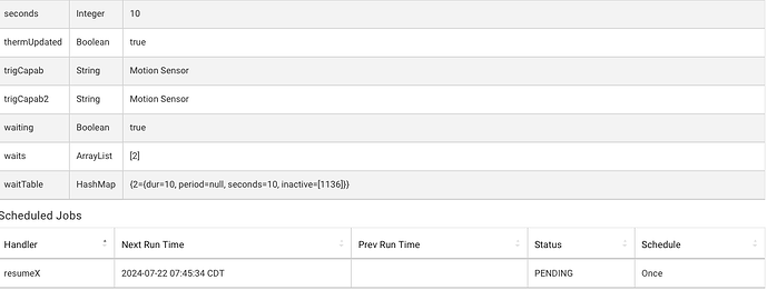

I have a handful of apps (5-6) using some element of time as a trigger. None of these are currently working. All work fine up to the point of a 'wait', for example, and then just sit there. Sunrise/Sunset also did not work this morning.
I was on 2.3.9.162 when this issue started. Troubleshooting thus far has been rebuilding database on .162 using advanced options reboot and rolling back to 2.3.9.158 when that didn't work, then rebuilding the .158 database. No change.
Example: I have a simple app that turns on a light switch when motion is detected and turns off the light switch 3 minutes after motion goes inactive (Changed to 10 secs for testing). Light never turns off. For testing I removed the wait and just had light turn on with motion and turn off when motion goes inactive. This works.
Thoughts or suggestions anyone? Every app I have that contains any element of time checking is not working and shows Scheduled Status of 'pending' when the app runs.
So I ran a test on a spare C7 that I added a contact sensor to and set up a basic rule for when the contact sensor opens wait 30 seconds and send a pushover message saying the door is open. That rule runs fine on the C7.
Created and ran that same rule on the C8 and the 30 second 'wait' is pending in Scheduled Jobs. FYI - The contact sensor is meshed from the C7 to the C8. This behavior is consistent on the C8 for all rules with any element of time related actions.

I have a C8 as my primary hub and a rarely used C7 for testing and troubleshooting. My problem is the scheduler on the C8 does not seem to be functioning. All of my rules are primarily Basic Rules with a handful of Rule Machine rules. Current situation is as described in my initial post; any/all rules with a time element (wait, delay/sunrise/sunset) stop working at the point of the wait/delay. I ran a simple test on the C7 this morning and it completed fine on the C7 and hung on the C8 (details in previous post). I'm at a loss for what to do next to resolve. I don't think this issue is self inflicted, but it is not beyond the realm of possibility. Any and all help or guidance is appreciated as my wife told me this morning she's about had it with this 'smart' home.
