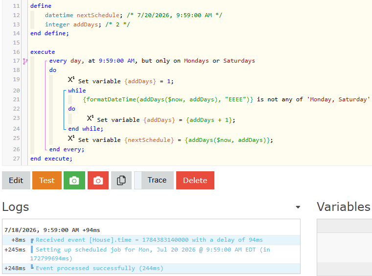

So, Webcore has no access to that either. Every time a job runs, you need to store the next run time in a variable. This will get tricky if it is a timer schedule with restrictions for certain days or months, as to calculate the next run time you will have to take any restrictions into account. Use the webcore time variables when checking restrictions, and the time functions in expressions for calculating the next run times to store.
Edit: I just wrote a piston to store next run time for a daily timer that runs on Mondays and Saturdays, but restrictions get ugly fast. You have to progress the timer through the week and check if the day restriction applies:

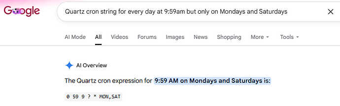

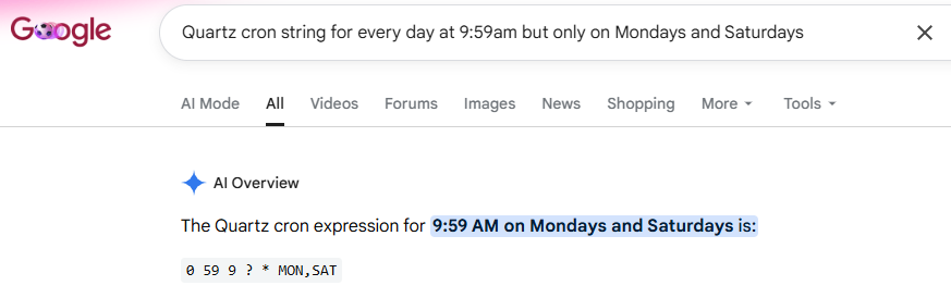

The idea is to add it to device code and create a virtual device. Add that device to Webcore, and then when a schedule fires, you use the device and the cron string that matches your schedule (AI can give you that), use the setCronString command from webcore to set the cron, then wait one second, then set a variable based on the value of the device attribute "nextRunTime"
