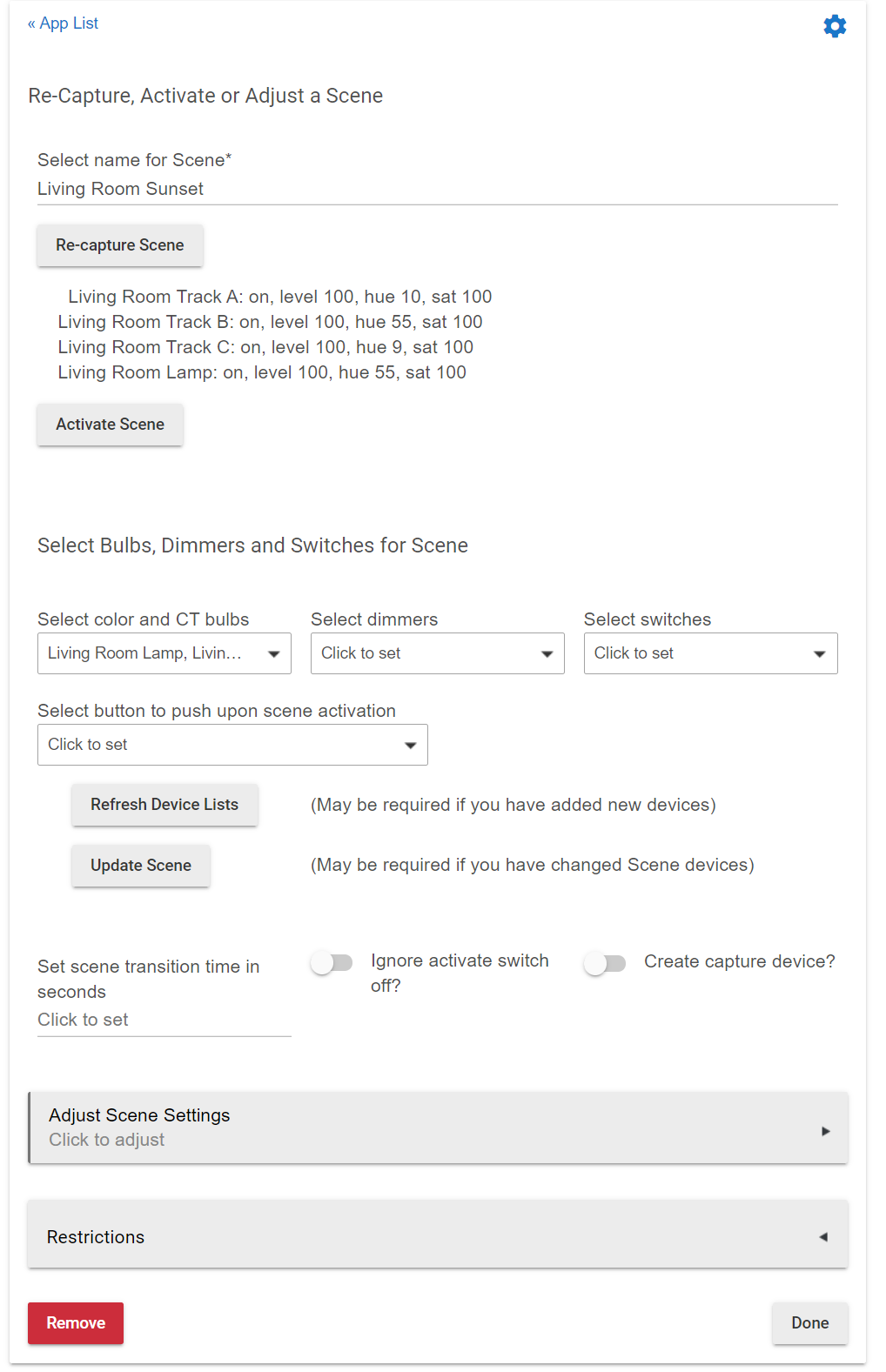

Here's the config for one scene with all colors set. It will not activate unless these lights are already on. I have a scene that is just like this but the bulbs are set to color temperature, and I can activate it even if the devices are already off.

Do you have color prestaging enabled for these bulbs? (You'd have to go to the device page for that bulb, e.g., "Living Room Track A," to figure this out. You will see an option for that on many, though not all, color-capable devices/drivers.) The behavior you're describing sounds a lot like what might happen if you do.
I do have prestaging on. I just turned it off, and... That fixed it. Thanks!
