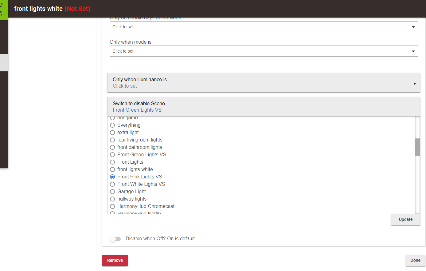

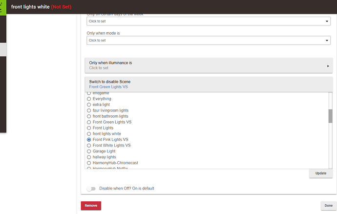

The change to be in a scene, under restrictions, "switch to disable scene" - can we have the ability to choose multiple switches please ? i'll explain my very specific use case.
I have 2 GU10 hue bulbs on the front pillars of my house. When I open the front door an contact sensor turns them on, and sets them white (scene white). A RM3 rule turns them off after 4 minutes.
With simple lighting, I have presence set them to Pink if my mrs comes home and Green when I come home.
In the three scenes, I have added virtual switches, so if i come home, and use the front door, the white scene wont activate off the contact sensor as it has a restriction (pink VS or green VS) but currently I can only choose one VS to have in the restriction. If I could pick 2 switches, im sorted.
incidentally I have all 3 VS being turned off by the RM3 rule in the 4min timer.
