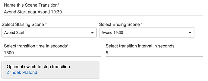

I've started testing scene transitions. And I have two questions with this.
As you can see Ive created a transition. Which should take place in 30 minutes, with intervals of 5 seconds
For some reason it doesn't end in 30 minutes. The transition got triggered at 19:00 and it ended at 19:44.
Is my interpretation from the GUI not right, maybe ?

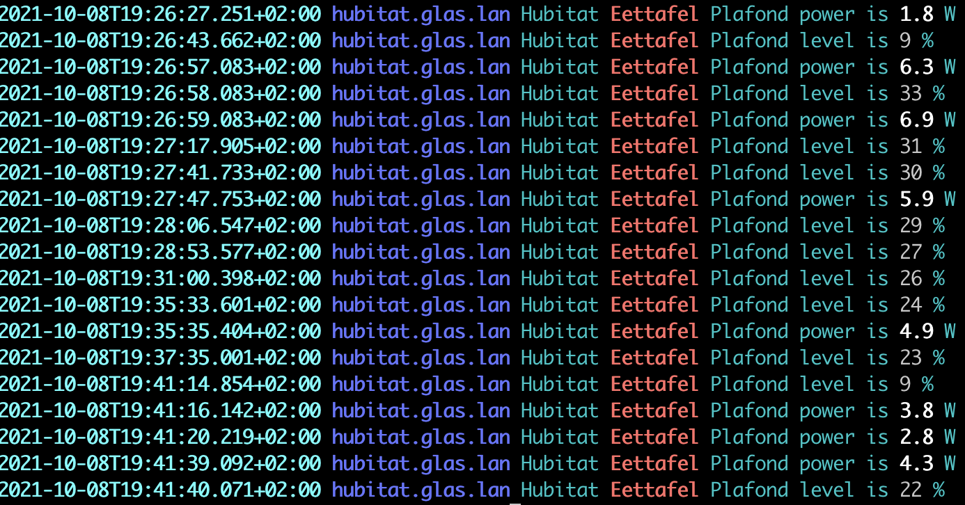

Another thing with the transition. I have one dimmer (Z-Wave qubino mini dimmer) that flips out .
It goes from 34% to 9% back to 33% then counts down and does it again from 23% to 9%.
That's not ideal lol. Any idea's why this is happening ?

Your configuration (and your understanding of it) looks OK to me. Do you have any other apps, including scene transitions or rules, that might be using the devices in question? Check the "In use by" section on the device page to be sure.
Also, it might be good to know what the start and end scenes are supposed to set the devices to, though it's certainly not going smoothly between those two in any case...
