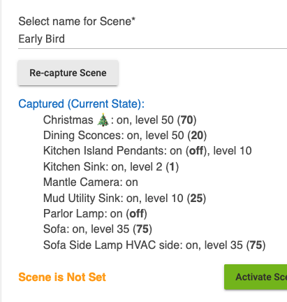

Here's the 'early bird' scene:
then here's the 'quiet morning' scene which runs next based on time:

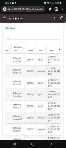

Scenes are fine, it's just showing you the full state of the device (e.g., on and level 30). It doesn't send both commands. So that doesn't explain the weird behavior of the light. Have you looked at the device Events, from the device page?
I see an event here but no clue why. It actually says physical so maybe it's reporting back something that's not happening?
The repeating commands is because I have a mode change trigger a scene over and over and over so it has a better chance of completing.
