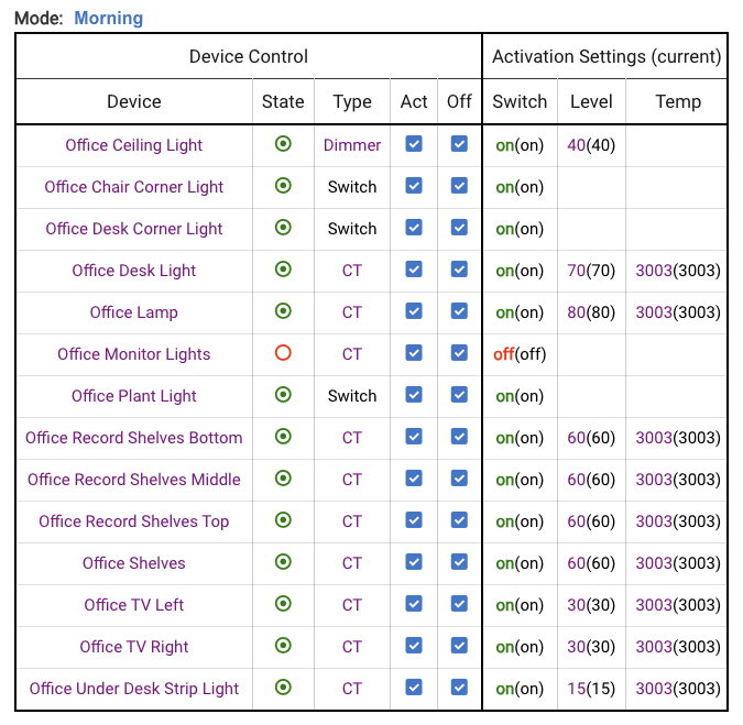

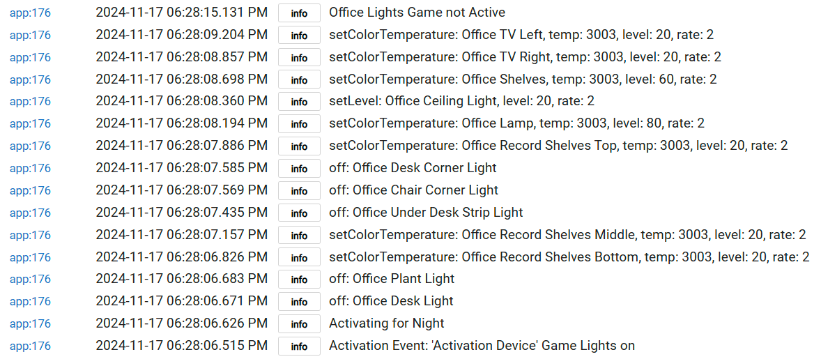

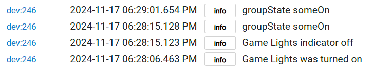

I seem to have another room lighting scene issue. I have my scene indicator set to "all set per table" and my settings match after activation but the indicator is off and the logs say it's not active after activating everything. Seems like a bug?
If I look at the activation device I see:
Which seems inaccurate.

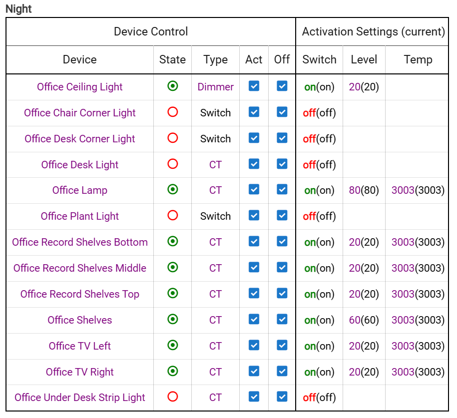

These are total shots in the dark and are admittedly complete hunches on my part, but I wonder if the "Off"-setting devices are a fly in the ointment here...
First thing I'd do is change those "Off" devices to be a plain Switch instead of CT.
Next, I'd try unchecking the Off-column checkbox for the Off devices.

These are a variety of switches and hue lights. Per my other reply, they all worked great up until recently. Also when you look at the table and current = activation settings, that should be what the scene indicator is looking at I would expect, so not sure why you would need to look any deeper. If there was a device mismatch, then you would expect it wouldn't report the matching settings. Activation works great, just doesn't always show the scene indicator as Active.

When I first set my RL scenes up a long long time ago, I just remember having similar issues in scenes where some devices were just set to "off".
The "CT" vs "Switch" setting shouldn't matter here at all, but that's something I always consider in each of my RL setups -- I try to "dumb down" that setting to the minimum required for each device (and what I need it to do in that particular setup).
The other thing to consider may be the "Type" of this RL setup's own Activation Device -- if it's currently set a a "Bulb" or something like that, perhaps try making it just a plain Switch.
I do believe the problem is the CT selection for the Off part. See if making those switches instead of CT fixes it. It's possible there is a problem with Off for this, and I will look into that. Please let me know if changing from CT to Switch fixes this. Seems like its a bug...
