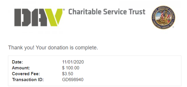

Donation submitted to https://cst.dav.org/ along with a company match of an extra $100.
