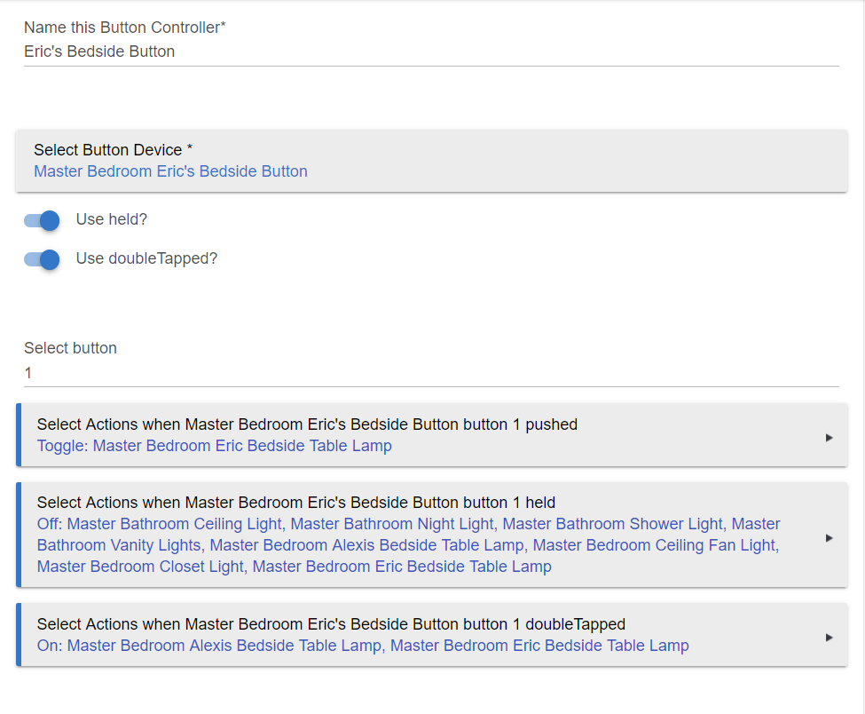

In Rule Machine, select the capability of 'Button Device', then you can construct an action for each press, double press, and hold (including conditionals). One rule-three different actions :+1:
