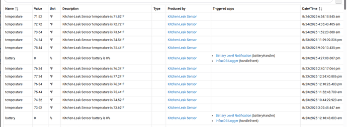

Already done that last week when I put in the batteries, I am getting the temperature updates so the issue has to be the battery circuit in the device.
You can see the logs showing "0" in each reporting cycle:
