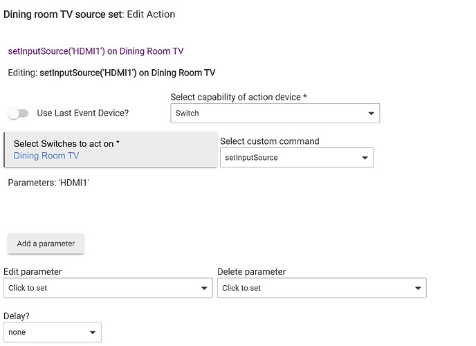

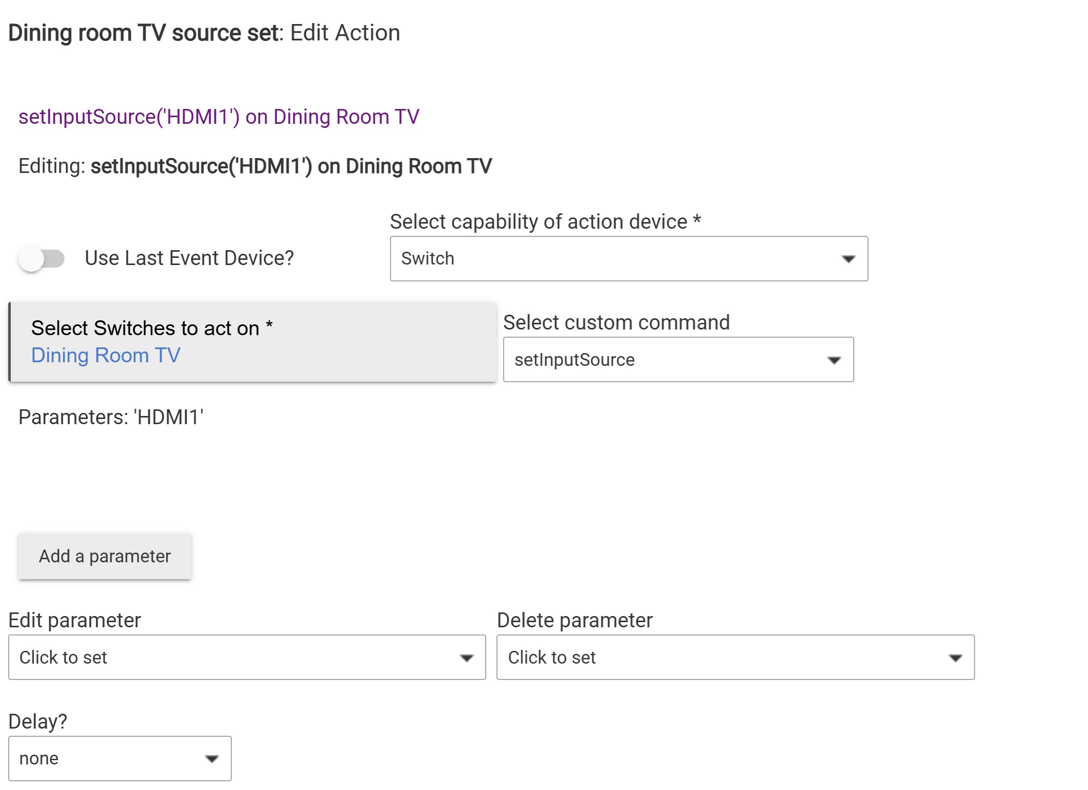

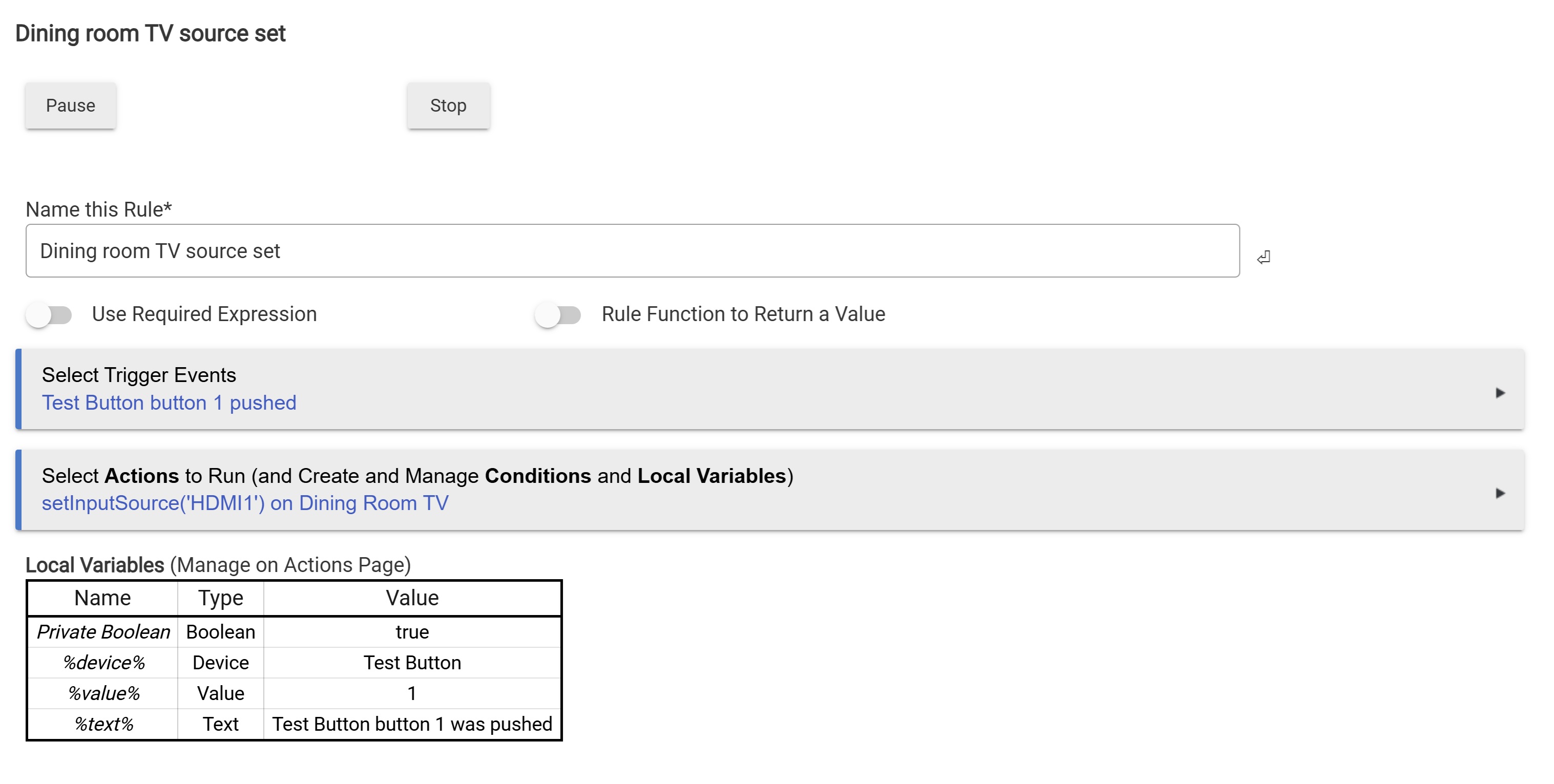

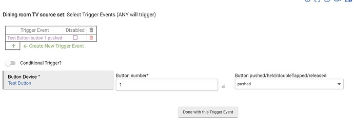

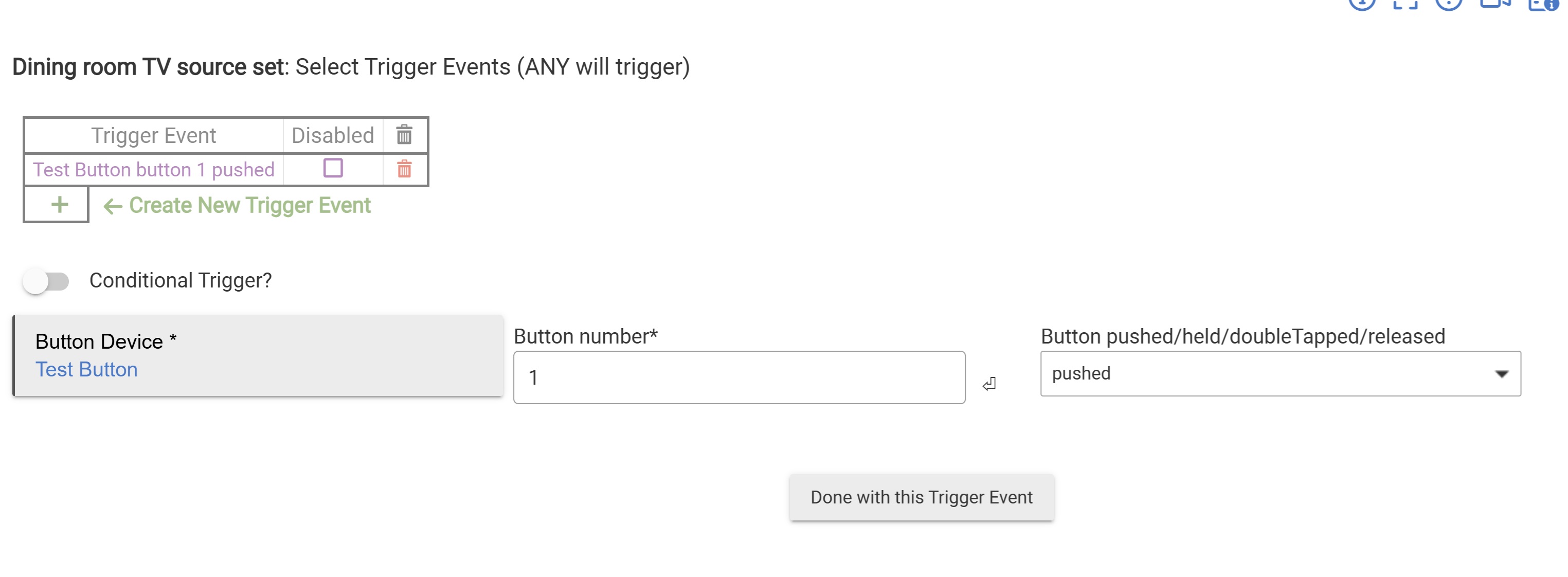

There isnāt a button for each individual source in the driver, but you could do it pretty easily using a virtual button/switch set to trigger the āSet Input Sourceā function via Rule machine or Webcore.

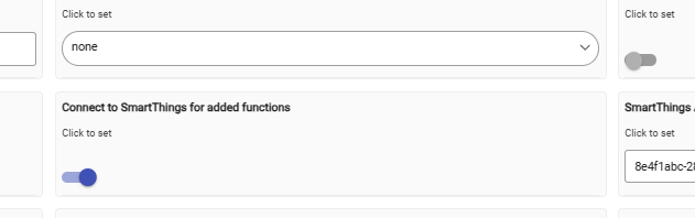

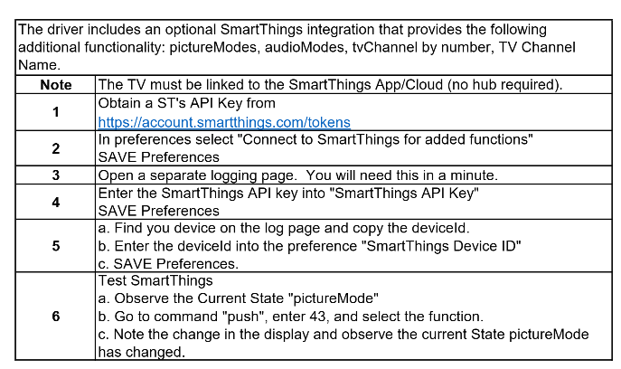

I've linked the TV to smartthings.
I've generated a personal access token.
I've selected "connect to smartthings" and saved, and opened seperate log page, entered the API and located the device ID

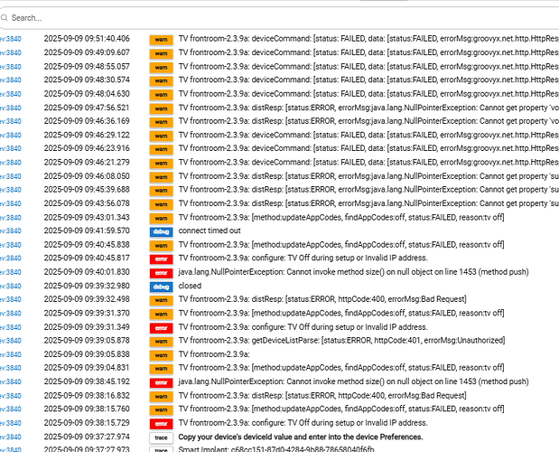

Just errors.
A bit lost to be honest. The standard controls work fine to switch on/off, but the logs are whining about IP not valid or tv turned off.

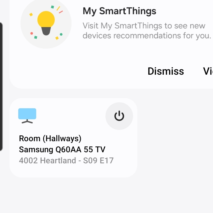

Might be a silly question, but can you control the TV with the SmartThings app? Have you assigned a static ip address to the TV?
Yeah to both. Works perfectly.

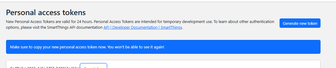

Gah, I suspected this would happen.
The personaltoken I acquired from the Instructions in the link seems to be temporary.
All smartthings functionality lost after 24 hrs.
Any pointers on how to grab a full non-expirimg token please?
Iām not 100% sure, but I think that was a ānot so SmartThingsā decision a while back. From memory, and again not certain, I think HubiThings Replica resolves the issue.
Correct. You should use Replica with Daveās drivers for Replica.
There is an optional native TV driver with Replica too, but it is not as robust as Daveās.
There is no other way to keep a new token alive if you donāt have the grandfathered tokens before the 24 hour change.

Would greatly appreciate if you would be willing to provide some additional detail for how to do this via rule machine...

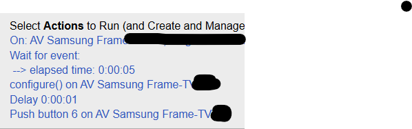

Below is the rule I have that turns on my TV and puts it into Art Mode. The wait for event is just a delay as sometimes there is a delay in the TV responding. The configure command makes sure it is connected. If you read upthread, before I inserted that, I had all sorts of issues. Then I do an other delay of 1 second. Then button 6.
PS- ETA that I don't use Smarthings at all. Just Hubitat.

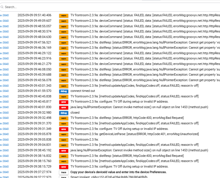

Trying to add a new 2025 model QN90F and when I enable SmartThings I start to get errors in the logs.
distResp: [status:ERROR, httpCode:401, errorMsg:Unauthorized]
deviceCommand: [status: FAILED, data: [status:FAILED, errorMsg:groovyx.net.http.HttpResponseException: status code: 401, reason phrase: Unauthorized]]
Any ideas? Did something change in the new TV'S?
