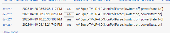

My 2021 Frame is again sending HE a signal that the Frame is off, when it is clearly on. When it does this, it triggers the automations that are supposed to run when the TV is turned off.
  • As with before, the TV does not actually turn itself off.
  • Unlike before, this time the TV does not immediately follow up by sending a signal that it is on.
    As I write this, the TV issued a signal about 40 minutes ago that it was switched off, and HE still thinks the TV is off. It is very much on...
    Any suggestions on what I might do to resolve this?

Perhaps I'm not understanding, but I don't think yesterday evenings incident was related to art mode or the motion sensor. The TV was on, in TV mode, and there was movement around the room, and suddenly the automations that are supposed to trigger when the TV is turned off triggered. When I looked in HE, the TV status was "swich:off, powerState: NC" TV was still very much on. And unlike when this happened about a month ago, the TV did not quickly resend a signal that it was actually on. It stayed reporting off in HE for the rest of the evening, including when it was actually turned off about an hour later...
Something causes this TV to report to HE that it is turned off when that is not the case. NOTHING has happened. I checked the log on the router, and the TV had been continuously connected for over 88 hours, so it is not an intermittent wifi disconnection.
Somehow, somewhere, the TV sends a signal (I presume it only sends such signals via wifi?) that it is off, and HE picks up that signal. Nothing else was going on in my house when this happened last night, and nothing was scheduled to happen in HE, nor was anything scheduled to happen in the only scheduling device in my house, a BondBridge. No remote for the TV or anything else was clicked. The TV just told HE it was off when it was not...
ETA: My HE had 4.0.3 of this Samsung TV integration installed when this occurred. I've updated to the latest version now. No idea if that makes any difference.
Power is determined by polling the 8001 port. The log is indicating the comms are failing. (I can never duplicate this at home.) This is the same method used in SmartThings. I actually allow one or two failed polls before turning off the set.
Does that mean the HE looks, via wifi, for a certain signal? Where is this "port?"
What information in the log indicates this?
I presume that data is YYYY-MM-DD HH:MM:SS.SSS when the incident happened, then the name I have assigned to the device, then the version of the driver, but after that, I'm lost.
"onPollParse:" does this mean the HE constantly polls the tv for status? Does it only report a change?
switch:off Is this the power switch?
powerState: NC Does NC stand for no change or something else?

NC = no connection. It is actually a time-out from the poll of the address!
The port is 8001. example: http://192.168.50.10:8001/api/v2/

I will look at it again. The no connection implies the poll message (above address) timed out (i.e., HE could not reach the address). In my testing, I can cause the same event in SmartThings.

Something to try. I was looking at the code and the following change may (may not) fix the issue. It will, in effect, increase the time period to declare the TV off.
Code starts at line 395 in the driver. Explicit change is to comment out line 399.
"runIn(5, onPoll)" becomes "// runIn(5, onPoll)"
