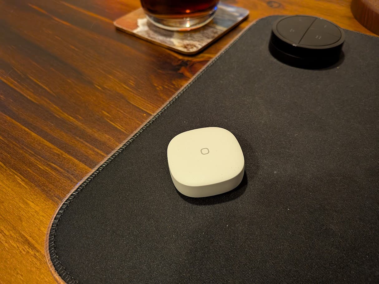

I'm pretty sure I have one of these some place, can someone post a picture so I can hint for the correct item?
This one is from before they got bought out / became Aeotec...
Found my button, testing the fix, unsure if it will make 2.4.2 or not...
