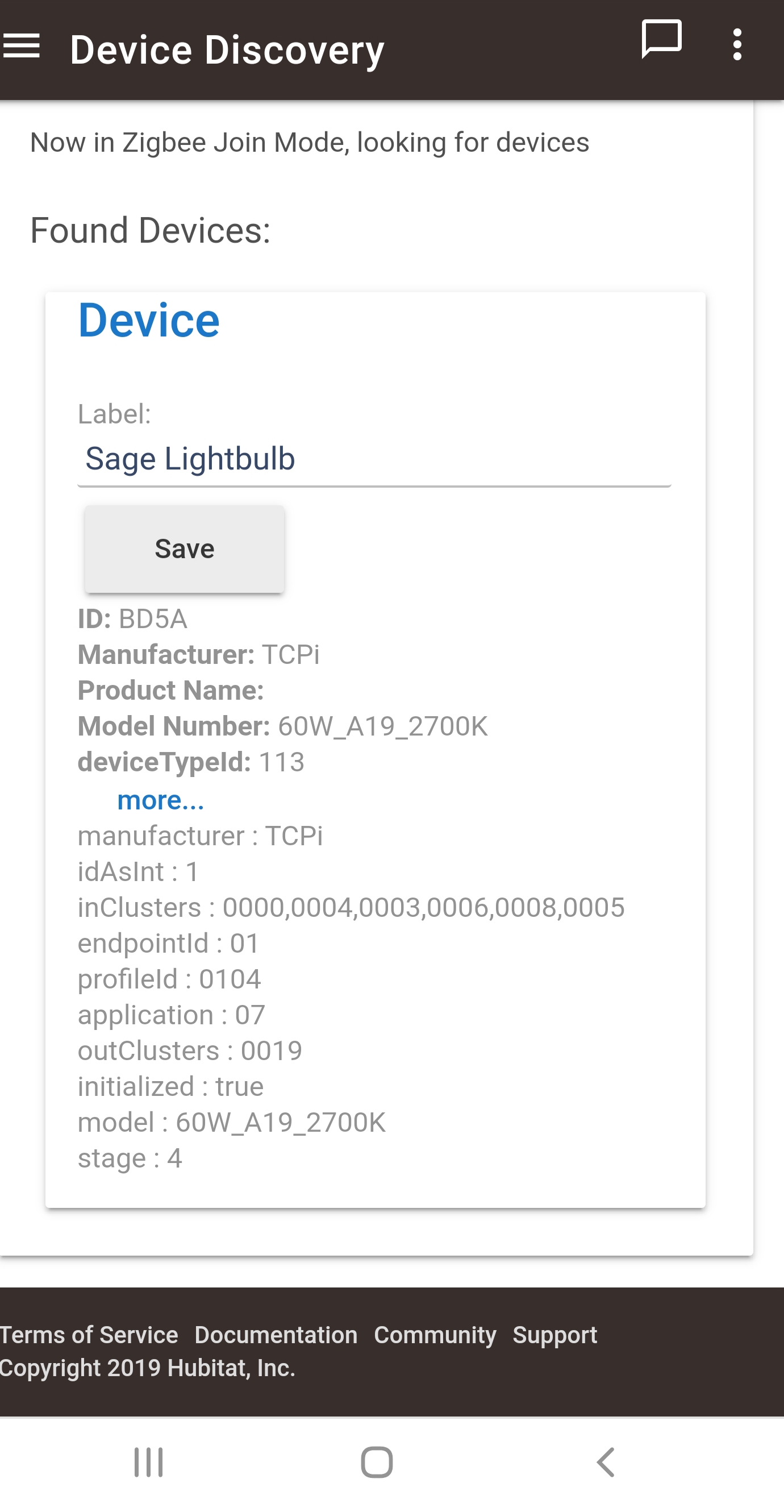

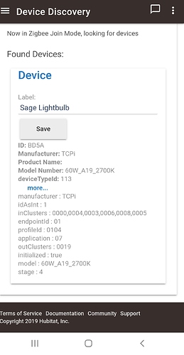

Does anyone know if the bulbs will pair with the Hue hub, by chance?
Yes, they pair as a generic zigbee bulb. They are terrible Zigbee repeaters, I've added about 7 and I'm now moving them all to my SmartThings hub to see if they will play nice if all over there via HubConnect.
The A19 bulbs actually pair as device. You have to switch them to Generic Zigbee Bulb. I will tag Mike to see if he can add the Fingerprint for the A19 bulb. I just received the A19 Bulbs tonight, they paired easily to my bulb hub. I keep Bulbs on a separate hub to keep them from mucking up my mesh.
@mike.maxwell Can you add the Sage A19 Bulb Fingerprint. It works with the Generic Zigbee Bulb Driver.
