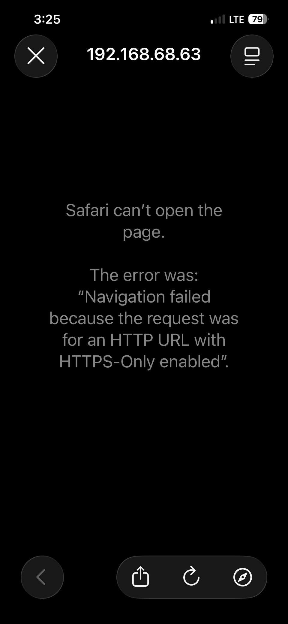

Running Hubitat Mobile App 2.1.33(424) on IOS 26.01 on my iPhone 14, when attempting to Connect to Hub it always presents an error "Safari can't open the page. Navigation failed because the request was for an HTTP URL with HTTPS-only enabled." see
From the app, can access Devices, Dashboards, Notifications, More, Settings, etc. but not "Connect to Hub".
The same Hubitat Mobile App on IOS 26.01 on my iPad works just fine. Have already removed and re-installed the app on my iPhone. Any suggestions for how to get this to work?
Running a C-7 hub with the latest firmware 2.4.3.133.
Disabled the Not Secure Connection Warning option on Settings-Apps-Safari and it is allowing me to Connect to Hub.
