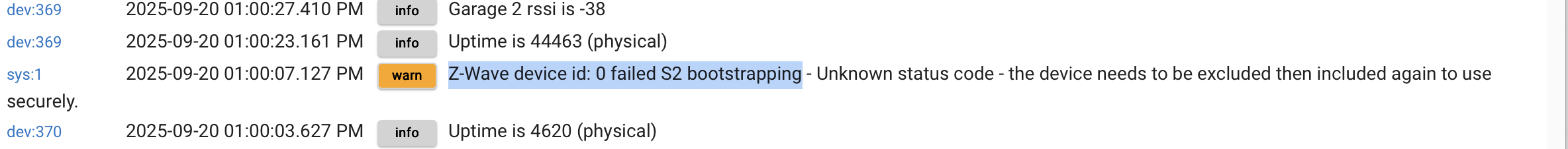

S2 bootstrapping - Unknown status code

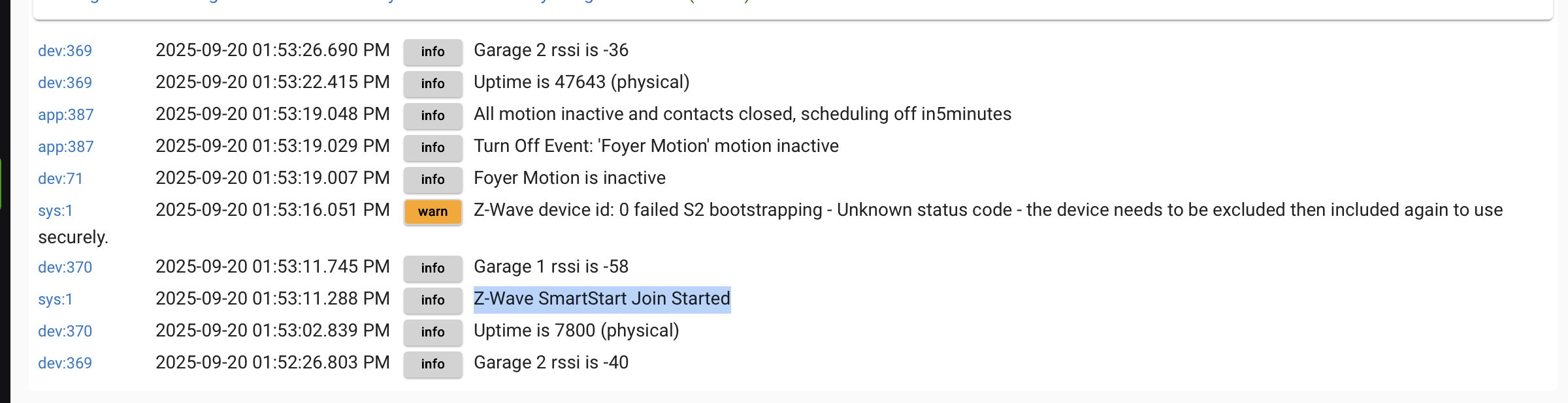

Pairing my first LR device and got this error. Looking through this thread it looks like I'm out of luck?
I just did a cloud restore, shutdown and re-joined but issue still persists. I have too many Z-Wave devices to start fresh.
