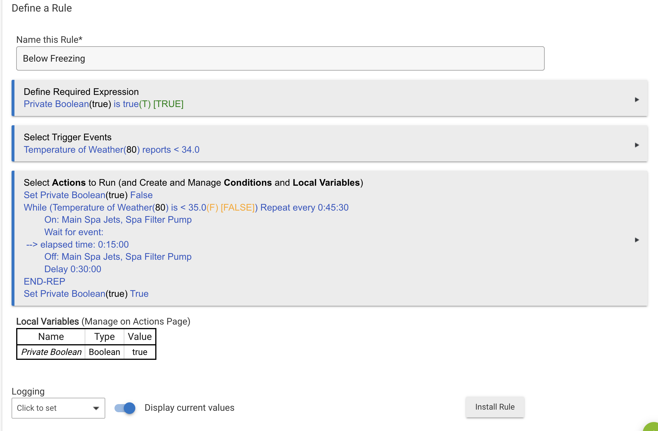

Well, that was fun for the first time using rule machine, took me a minute to understand the workflow but makes sense now, can you look at this screenshot and confirm it for me?
I like the overall approach but you don't need the Delay 0:30:00. All you need is the On, Wait for 15 minutes, then Off. Set the Repeat to 0:45:00 and the jets and pump will stay off for 30 minutes.
That's fair, although should hurt anything. I was headed a different route but realized it wasn't going to work. That one did require the delay so I didn't think to take it out.
One point to make, although it doesn't matter here. There is a difference between 'wait' and 'delay'. Waits will auto cancel if the rule is triggered again. Delays do not. There's an extra option for 'canceled delayed actions' to stop them from running.
An analogy. You're at the start line of a race on an oval track. A wait would be using setting using a timer but you reset it every time someone passes the start/finish line and start the countdown over. So the countdown would only run out of no one crosses the line before the time is up.
A delay would be starting the countdown and then starting a new countdown every time someone passes. Each countdown will still end once the time is up. You'd just have a different countdown for every pass.
To make sure the second wait has time to finish. As pseudonym pointed out though, the second wait could just be removed and the repeat set to a flat 45 min.
