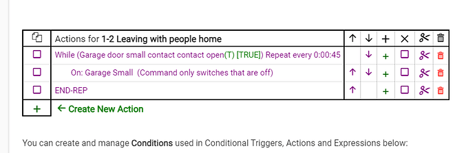

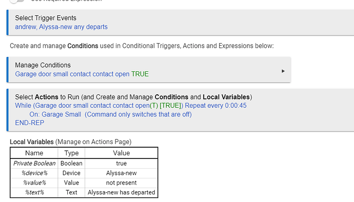

not sure why this is not working ?

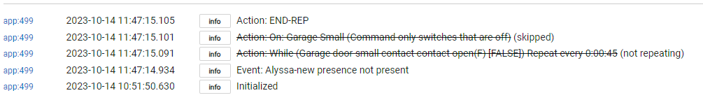

what is broken ? it should have closed the door ?
Unless your logs are from another time, it's clear your rule is "running." Do you mean that it's not performing the specific actions you expect? If so, the same Logs are your best bet for figuring out this problem. The contact sensor you're testing the state of in your "While..." expression is apparently closed (because that expression evaluates to false--note that this is displayed in your log entry for this action), so nothing inside that repeat is running. And that's the entirety of your actions, so there's nothing else to do.
So, if that's all consistent with what you're seeing: the first step is figuring out why your contact sensor isn't reporting correctly.
the parts is it did report
but like 10 minutes late - weird
