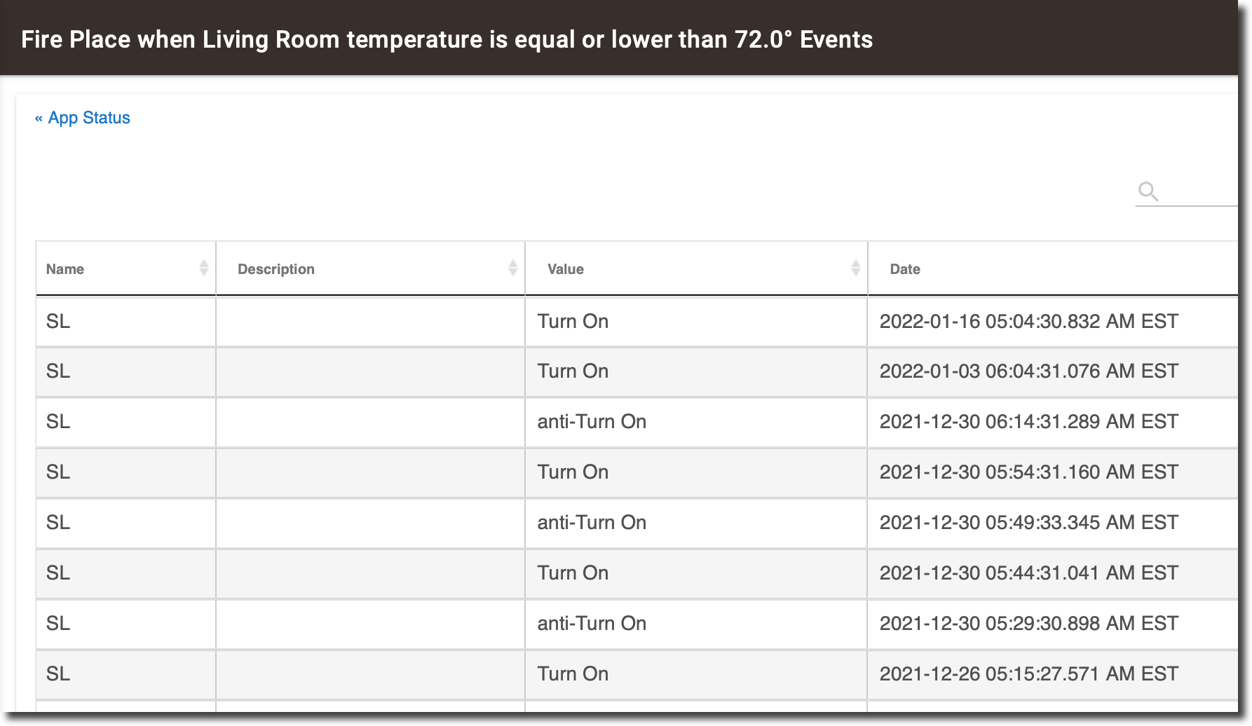

I have had this issue for some time, but it seems to be becoming more frequent now. Some of my rules stop working randomly, including Basic rules, RM (Legacy) & Simple Automation rules. At the same time, other rules within those apps keep on working. Here is one example of randomness, but I can share more from other apps with similar behavior (or where it didn't fire at all). And yes, it has been colder than 72 in this case and thus I expected it to fire everyday. I am on C7.

It could be that the rule/HE thought the switch was already on and therefore did not send the command.
Just something to try.
I don't see conclusivve evidence for this. What you'd need is a lack of log entries for then app at the expected time (which you should have since I see you have logging enabled in the app). What appears to be a rule problem is often just a device not responding as you expect, and the event history you did show for the device tells you what the device reports back to the hub, often in response to a command, but not what commands were actually sent.

If I am reading this correctly, your rule is triggered on temperature events between 5am and 8am, so look into the events for the temp sensor.
How often is it reporting? What is it reporting and when?
