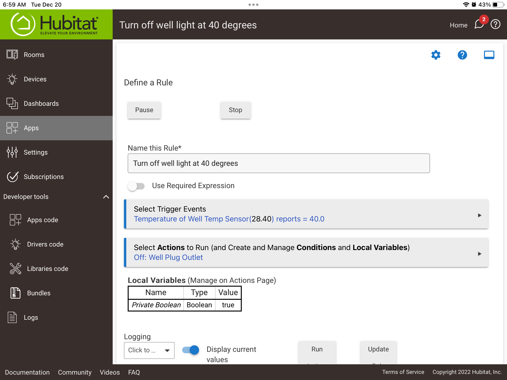

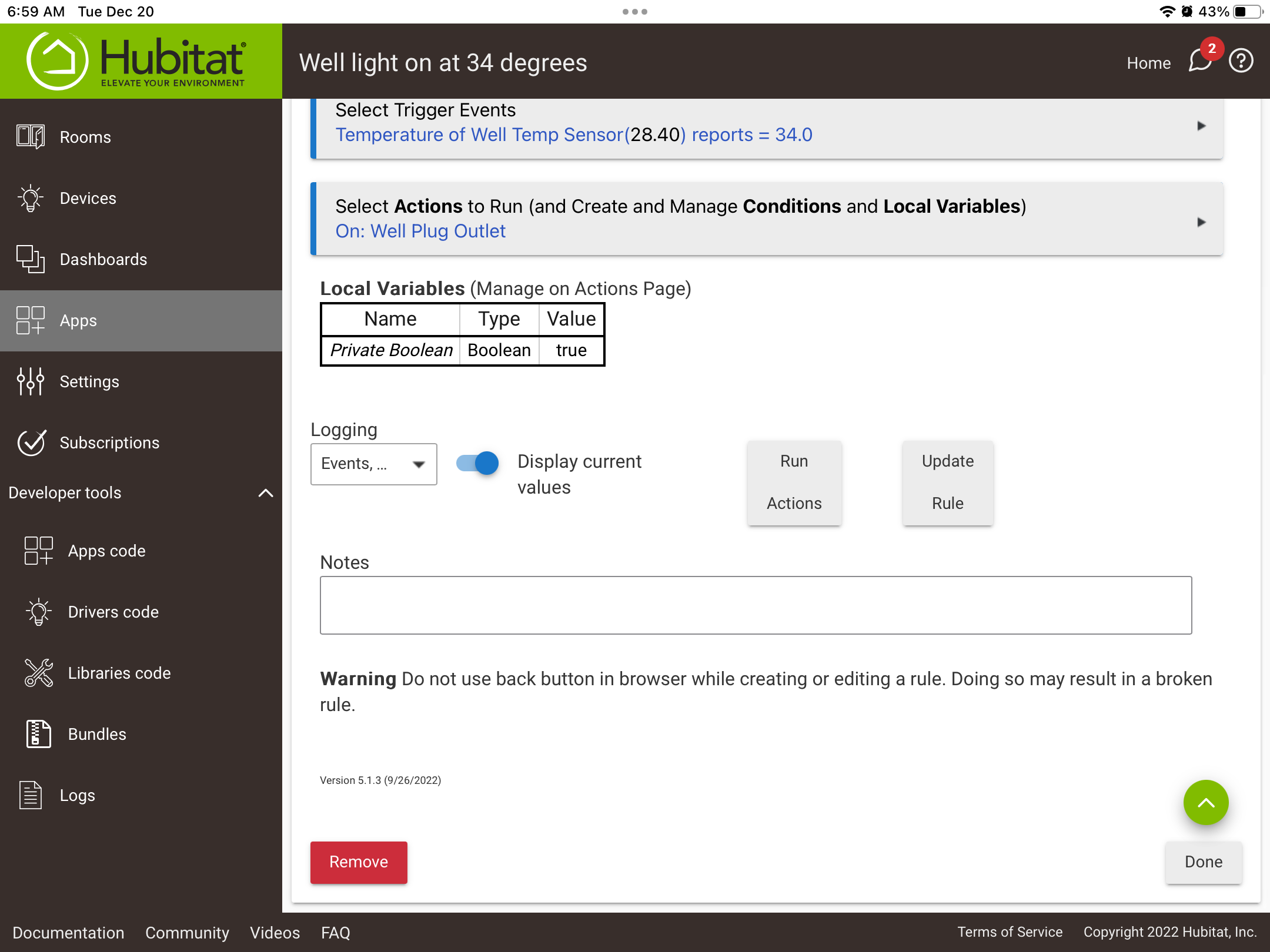

I am having an issue with running two rules. I have a rule that turns on a Iris V1 Smart Plug by reading a low temperature of 34 degrees on a Iris V1 Door/Window Sensor. Then another rules that turns the switch off when it reaches 45 degrees. Neither of these two rules seem to run when each temperature is triggered. I have erased each rule, and recreated them with the same results. I am not sure what I am doing wrong. Can someone please help me?
Try < or > instead of =
It's possible your sensor is skipping right over your trigger temp when it reports so the rule never fires.

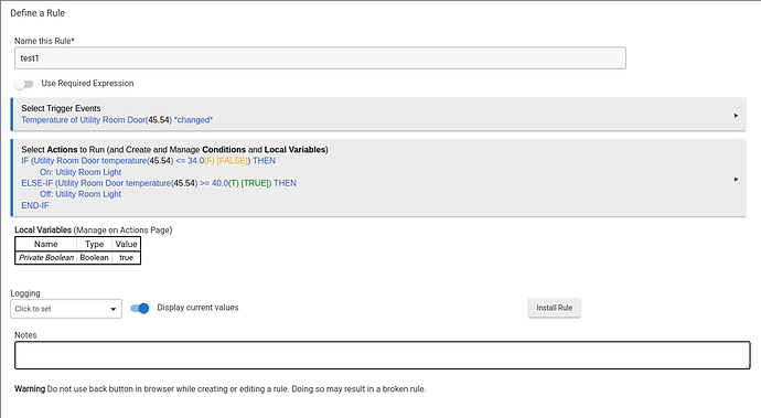

Try this rule instead. It combines both options in one rule and should work. Use the sensors and switches that apply to your situation.
I agre, the key here is the = as the temperature likely will go from 29.X to 30.X where X might only rarely be 0. Changing to a >= or > in the first rule, and <= or < in the second will likely work.
