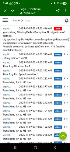

I got this error message now from the rule. If i go in and run action it works. Any suggestions?
So app:792 is the rule, not the integration? What is the rule (i.e., share it here)?
