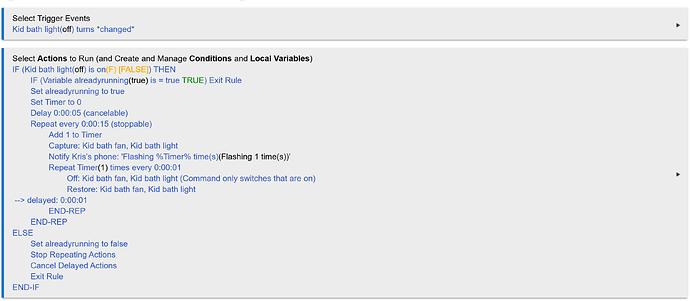

Hey All,
My kids have ADHD. And they're kids, lacking all concept of the passing of time. I decided I wanted to create a timer function for my kid bathroom lights. The idea is that the lights (and fan) blink off for 1s once for each 5 minutes of time passed since the lights came on. So at 10 mins into the shower, it should blink off for 1s, then on for 1s, then off 1s then on. Then at 15m, it would blink 3x. If the switch is used to turn off the lights, I want it to interrupt the whole thing and stop. Right now, for testing, I have the durations set shorter, so disregard the times. Here's my draft:
I'm getting stuck because the trigger is also the action in the blinking, so I think it's firing concurrent instances of the rule. I tried working around that with the local variable, but clearly it isn't working for me. Ultimately, the light just starts going berserk on and off, and I'm not getting the intended timer behavior. Any guidance?
I'm pasting some log below. At the start (bottom), you can see where I fire the first trigger. The local variable (alreadyrunning) was set to true because I had to interrupt the prior run. So that first trigger just evaluated to my else statement, set the alreadyrunning variable to false, cancelled repeated and scheduled actions, and ended. Then I fired the light a second time, and you see it just go nuts from there.

I should have noted: the switches are hooked up to a zooz zen52 double relay
This would be easier with a dimmer, as ON can trigger the timer to start, but the signal could be a dim and brighten instead of a blink. You can't use the same attribute (switch) as both the trigger and the action without causing a retrigger like you are seeing. Set Level would not retrigger the rule based on ON.
Or use a different device as the signal, like another light or a smart speaker device. Or use a different device like a smart button to turn on the light and start the timers, and base your blink times on when the button was first pushed, not the light switch state.
Another option is to use the isPhysical flag to determine if the light was turned on or off at the switch physically, or digitally by an automation. Only a physical ON starts your blink timer, and only a physical off stops it. The digital on/off events from the blink would not retrigger the rule.
Edit: I don't use Rule Machine, but it looks like in RM you determine a physical On vs a digital On based on if you choose Physical Switch or Digital switch in the rule. I've never played with that in RM though, but in Webcore there is a choice to see if the event isPhysical to make that determination.
You could avoid this by wrapping the actions in a Private Boolean. Set the PB to be False as the first action of the Rule, and set it to be True as the last action. Finally, require the PB to be true for the rule to trigger.
The Rule Machine documentation has more information on how to use a Private Boolean.
Also, for future reference, just post a screenshot of logs rather than the log text itself. Screenshots are way easier to read .....
And if really long, wrap that in a Summary. Easier for those on phones. Select item(s), then select the gear, then Hide Details.
Summary
This text will be hidden
Seems like triggering the rule from the physical ON event would be easier, as the blinking will only be digital and not retrigger. No real need for a boolean to be involved here.
Thanks! I did the summary
You're kind. I just turn the lights out and leave them in the dark :slight_smile:
You have found what I found. RM echos trigger events about 250ish ms later. Make your trigger conditional on a Private bullion then the first action is to disable the trigger and the last action is to enable it. Another way is to wait at the start until say a half second elapses without another trigger wait period event then proceed.
