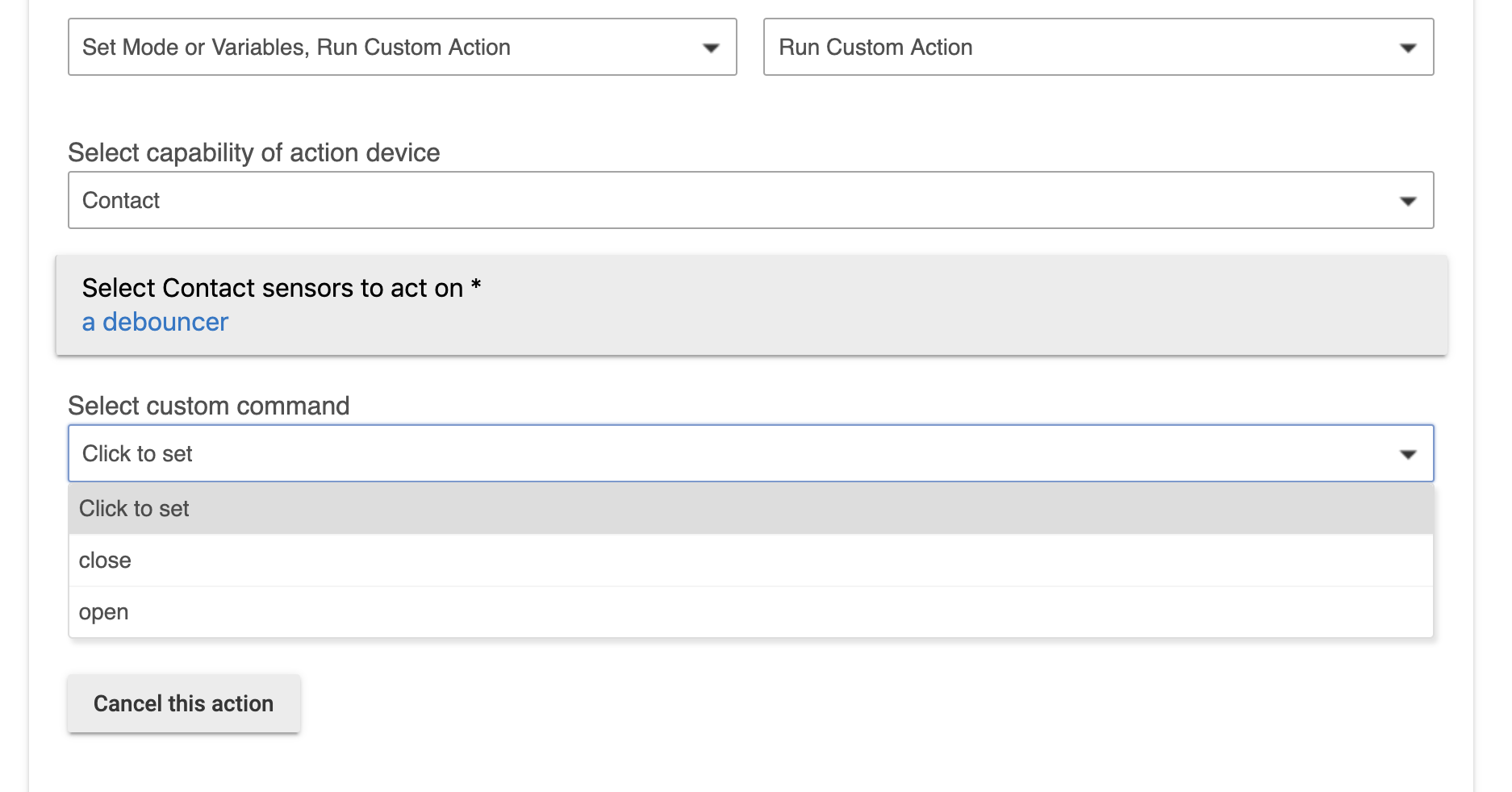

Yes, you need a Custom Action. Like this below. Notice that open and close are available in the list of actions you can do. This will only work with a virtual contact device.
@bravenel Thank you very much! That did the trick.
Craig
