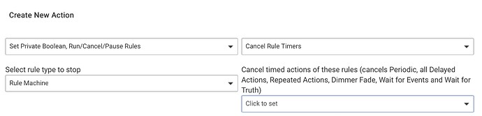

Is there a way to create a rule that will cancel a different rule? Case: Rule 1 is a count down timer. If a switch in Rule 2 is turned OFF, I’d like to cancel Rule 1. Can it be done?

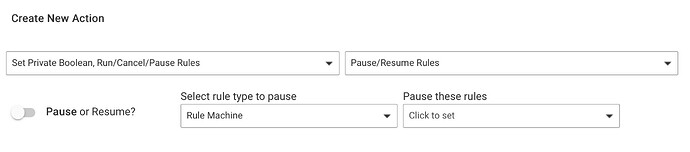

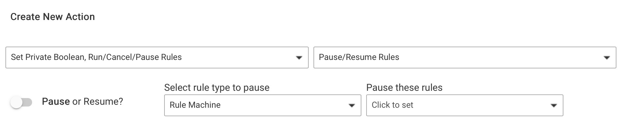

Thanks Sid- I saw those but I thought PAUSE would not be a good option because I would not want it to run again. I wasn’t sure about cancel timed actions because it is not actually a timed action, it is a repeat. Would that be considered a timed action?
No need to run it again, you can pause and resume with a delay

Yes you can create another rule to cancel this rules timers. Or you could just make trigger for Switch 1 “changed”
Add a Conditional action at the top of the rule - if switch 1 is off, cancel rule timers “this rule”, exit rule

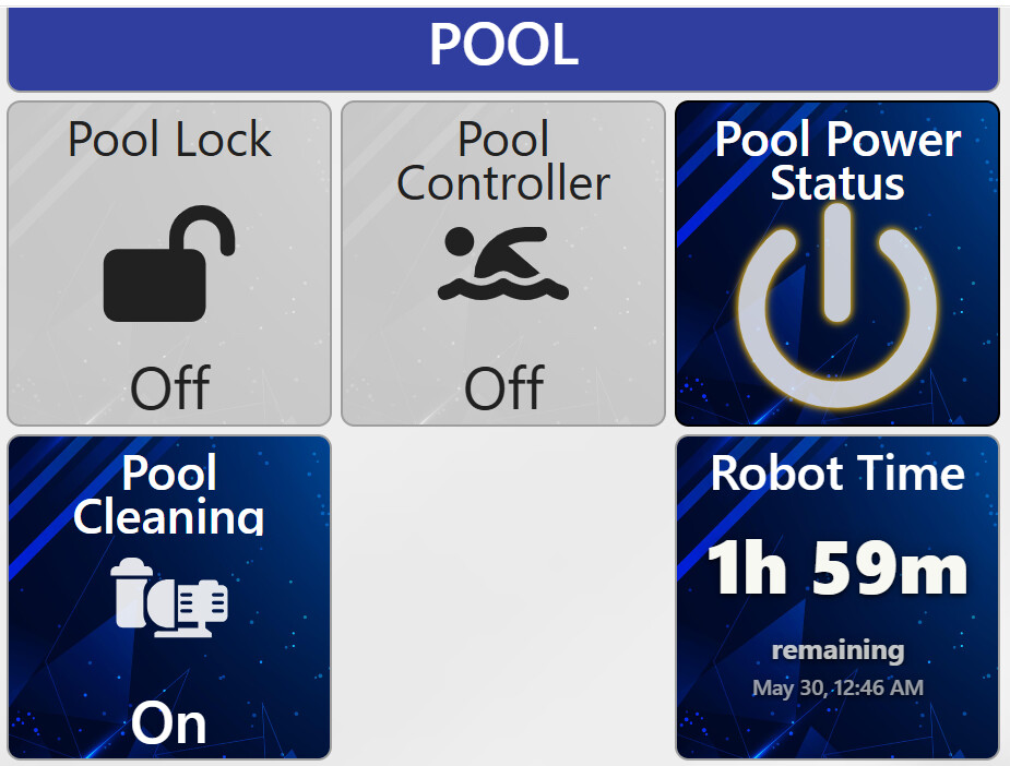

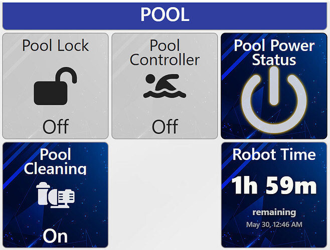

(1) - I have a virtual switch that is used when cleaning the pool “POOL CLEANING SWITCH”

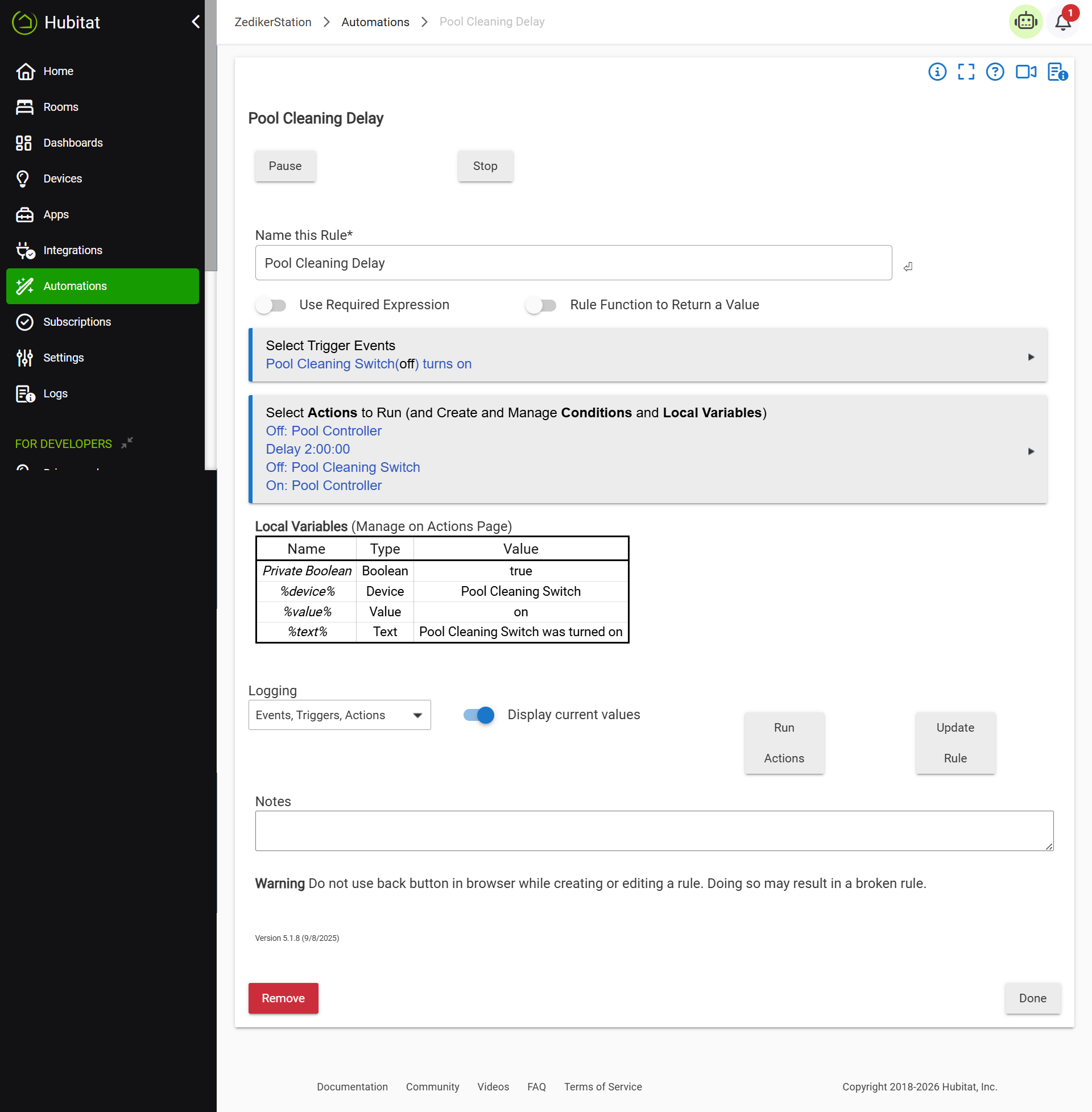

(2) - I have a rule that when “POOL CLEANING SWITCH” turns ON, it does stuff. Here is the stuff:
(3) - I have another rule ”POOL CLEANING COUNTDOWN DISPLAY” that is triggered when the above “POOL CLEANING SWITCH” turns ON. It is here:
That sets a timer to 120 minutes and starts repeating until it gets to 0. (ignore the -822 because that was caused by some editing last night and the rule did not stop repeating)
There may be times when I want to turn OFF the “POOL CLEANING SWITCH” for some reason or another, or just start the cleaning over. Turning OFF the “POOL CLEANING SWITCH” and turning it back ON will take care of that, but I will have 2 instances of the “POOL CLEANING COUNTDOWN DISPLAY” running. I simply want to be able to turn OFF the “POOL CLEANING SWITCH” then turn it back ON, which will trigger both rules. I think I need a rule to kill the repeating in the “POOL CLEANING COUNTDOWN DISPLAY” when the “POOL CLEANING SWITCH” is turned OFF.
… Have at it…!
For the first two, I would replace the delays with “wait for event: Elapsed time”
This will restart the timer if the switch is cycled during the wait
For the last, I would add an - OR Switch is off to the conditional to the Stop repeating actions into the first part of the repeat.
If Minutes remaining <= 0 OR Switch is off

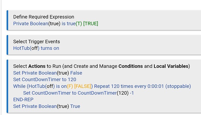

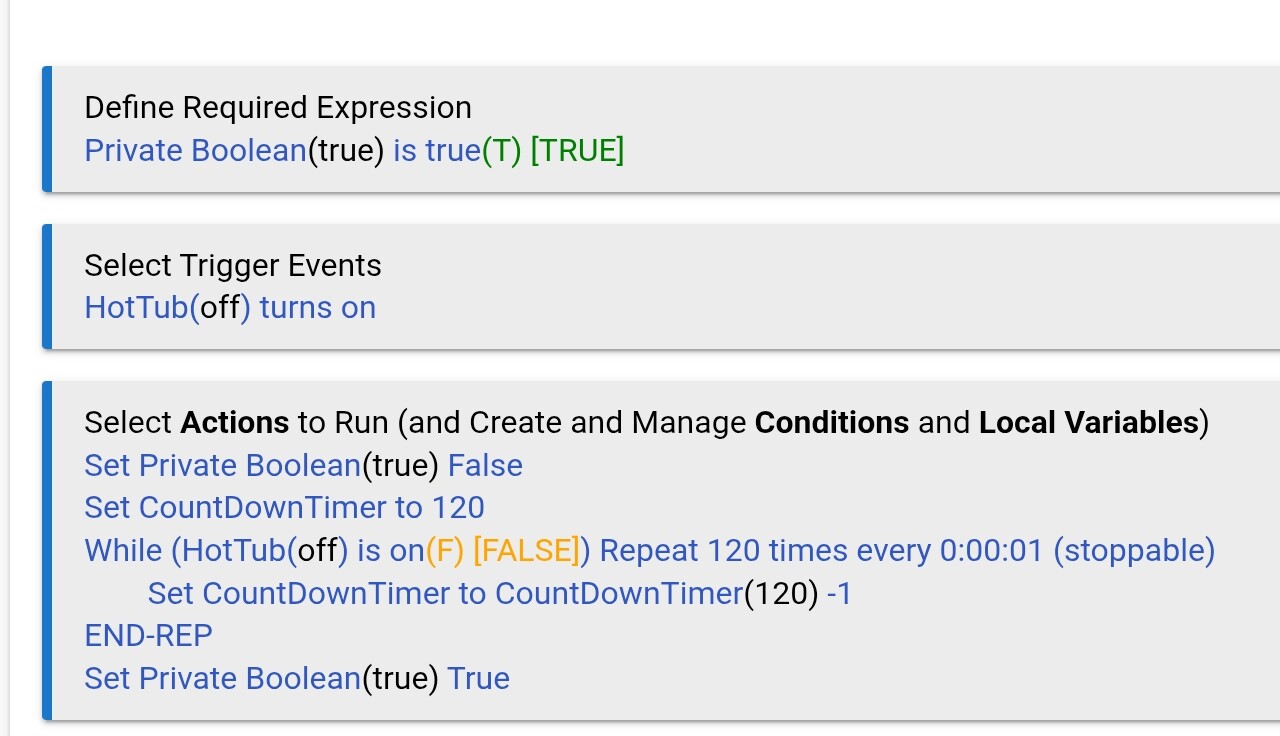

The other option would be to use a repeat while option (using switch is on as the condition). You still set the every one second for the repeat while option and avoid having to exit using the if conditional by setting the number of repeats. (did not include the update display action, but you get the gist.
For this one, you would likely want the private boolean (Note: if you rapidly turn the switch off then on -in the middle of a one second repeat-, it should continue the original count down. If you turn it off for greater than one second, and then back on, it should stop the repeats and restart with a new countdown.)
Edited to add, just realized that you wanted minutes instead of seconds on your countdown timer. So, you would need to wait longer than a minute between turning off and back on to reset the timer countdown in either case, you would only have one instance of the rule running)
