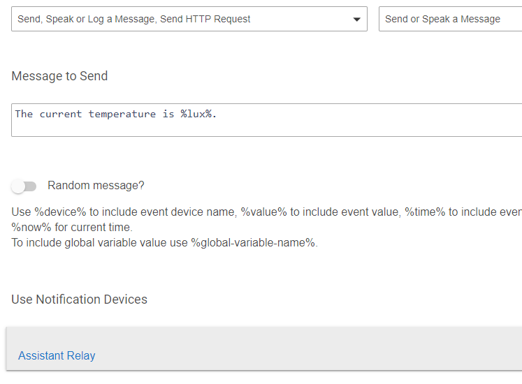

I want my Google Home to listen to the "outdoor temperature" command and trigger a switch through IFTTT on my Hubitat. Then I want it to speak back true Assistant relay the temperature value of my Hue outdoor motion sensor.
I have IFTTT, Assistant Relay and all that working. My headache comes in how i can get Rule Machine to read the temperature value and have it send to the Assistant relay when a virtual switch becomes active.
Set the temp equal to a variable and then speak the variable.
I used the variable lux since that's what I already had available but you can use whatever you want. It looks like this when you're done.
