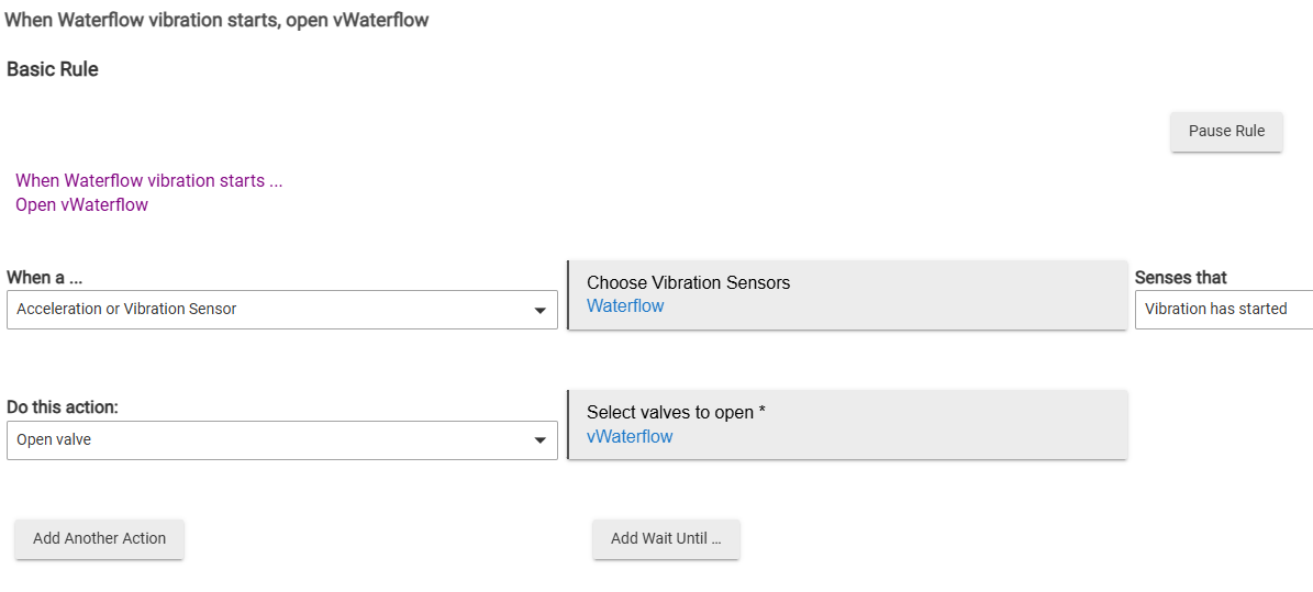

  2. Create a new Basic Rule that sets vWaterFlow to open, when the water meter vibration is "active."

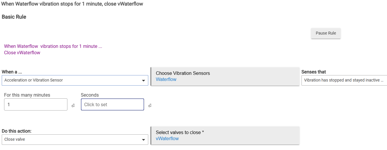

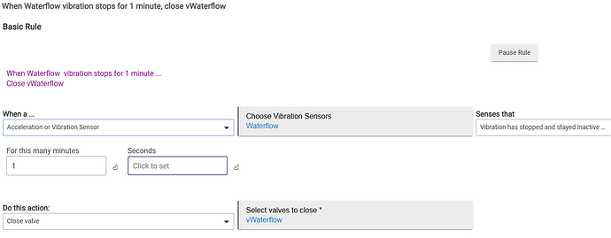

  3. Create a new Basic Rule that sets vWaterFlow to closed, when the water meter vibration is "inactive" for at least 1 minute.

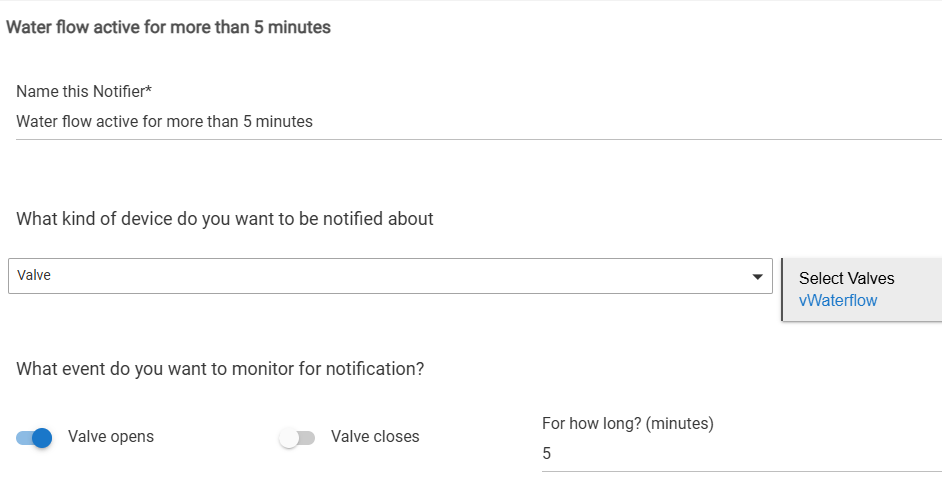

  4. Create a Notification that uses the virtual device, vWaterFlow, not the actual vibration sensor itself, to notify when it has been "open" (i.e. water has been flowing continuously) for more than 5 minutes.
