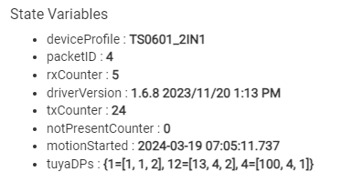

I've been struggling with these Tuya 2 in 1 sensors since I updated my C7 to the latest firmware 2.3.8.125.
I have 3 of these devices. Initially my issues with 1 of the 3 happened immediately after updating the firmware but because the other 2 were fine I thought it was a coincidence. But now it looks directly related.
I've ended up trying to remove and re-add these devices and each time I end up with tuyaDPs : {} which I believe @kkossev mentioned somewhere is a known issue, the device is no longer communicating with the hub. I see nothing in the logs either of course.
I tried remove and re-add with various versions of @kkossev driver including the latest (1.6.8).
I wonder if anyone has had any luck adding or using these with the latest firmware on a C7?
Somehow 2 or the 3 devices were still working until I removed and readded. Now they're all dead.
This is so frustrating.
Now suddenly 1 started working, something is insanely flaky.
