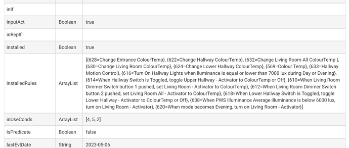

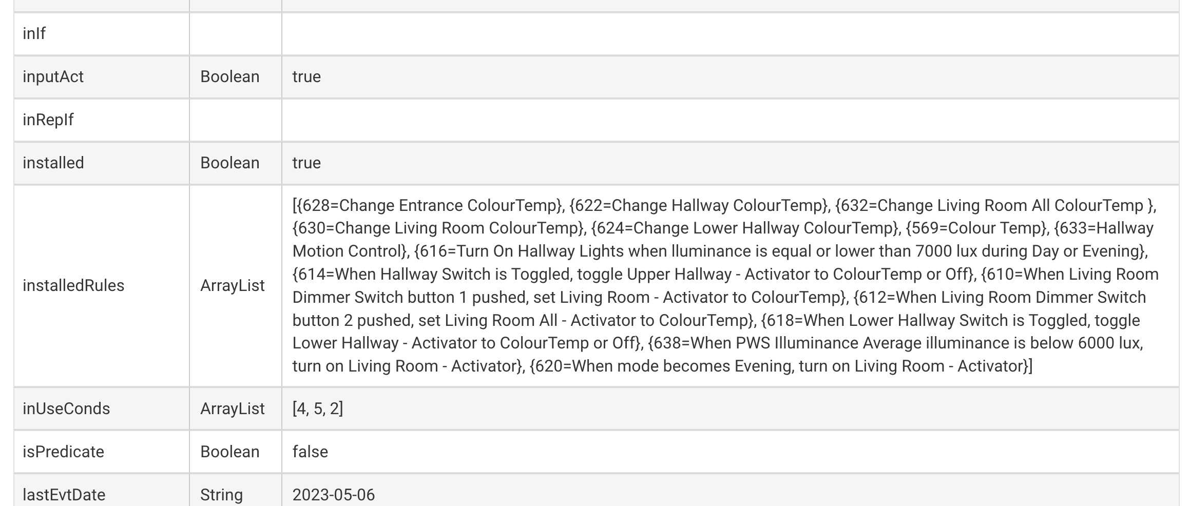

Please post a screenshot of a portion of Application State from the App Status page. Specifically need to see near the middle on the list, where the 'i's are. Looking for 'inUseConds'.
This?
Yeah. That doesn't show an earlier problem, since fixed.

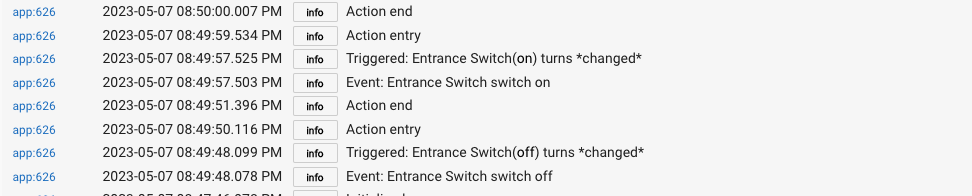

Ok, I turned off Action logging and put in log events. First one at start of actions and one at the end of the actions. This is from a couple of days ago:

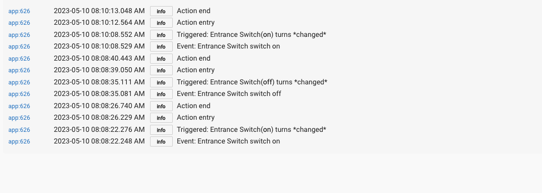

Then this one from now. Note how the latency is still increasing.
Thanks, we are investigating this. I think we can rule out RM logging. In fact, I don't think this is actually caused directly by RM, but rather something in the platform.
