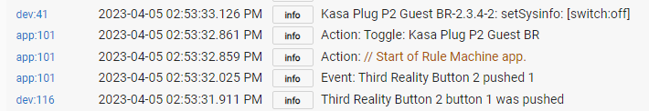

Here is an example log, showing the current 800 millisecond delay from the app event to the first app action. There is minimal delay from the button push to the app event, and from the first app action to the second app action to the device action.

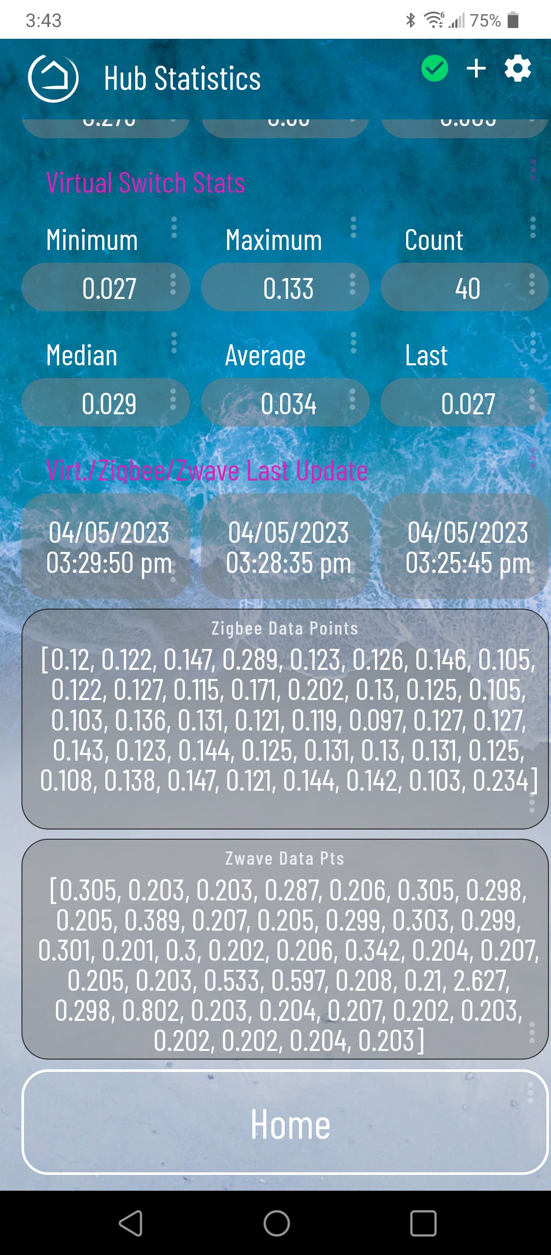

Interesting. I have a device and log times with hub watchdog and i am not seeing a degradation of times.. ie

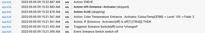

Here is a log straight after boot:
Here's a log after about 23 hours:
Let me know if you need more info. Also I PMed you my hub id earlier if you need to have a look.
