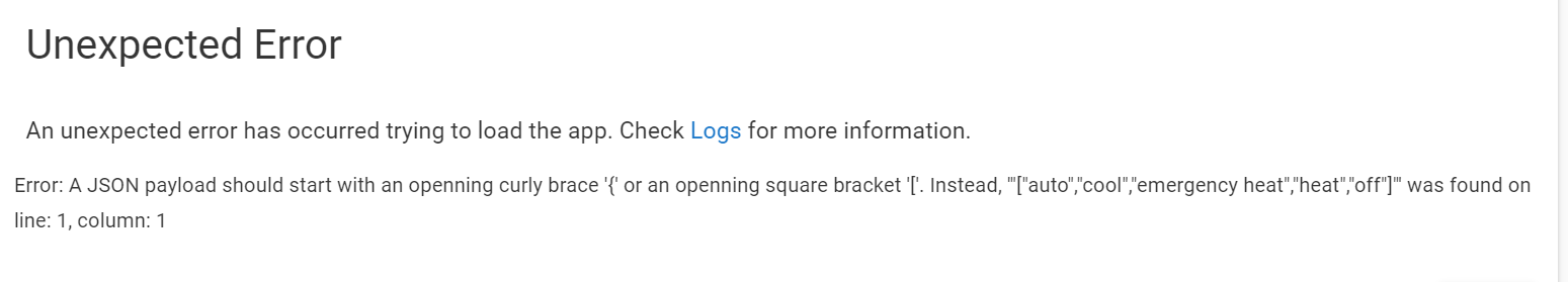

I was working on a new rule and had "paused" a couple existing actions and was adding another action to replace it. However, when I clicked on the green + icon to add a new action above an existing action, this error appeared:
After that I was unable to add any new actions, regardless of putting them between existing actions, or at the end of the existing set of actions using the "<--Create New Action" option. Any attemp to add an action resulted in the same error. Saving the rule and coming back in didn't help, nor did deleting one of the paused actions.
Did you ever have a thermostat selected in this rule, by chance? If so, what driver is it using? It looks like it's putting quotes inside what is supposed to be the JSON list of supported operating states. The format for this attribute was recently clarified, and I'm not sure that an "old" format is supposed to break any apps (yet), but this doesn't even look like that but a mix of both. It's probably a good idea to address that in the driver if possible.

Yeah, it's possible the rule already cached something by that point that broke it (though, not having written the app, this is a guess and I don't really know if/where it stores the information). The current virtual driver definitely seems fine to me--the part I'm not sure of is what this did in the past. The string in your error message is a bit unusual since it's neither the old (Groovy List as string, even though I think it was always supposed to be JSON) nor new (a legitimate JSON array) format from what I can remember, so I'm not sure how that may have been set.

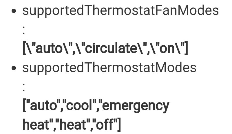

Some differences in supported modes between the two:
Original:
New:
2022-10-12 08_34_26-Chrome Main
But I'm good, just sharing in case you were interested.
