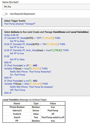

I have a Minoston dual plug that has a bad habit of turning itself on or off on its own. I use it to control out pool pump, and have a rule that is supposed to run when the plug goes rogue and returns it to the desired state. Last night it went off, but the fix rule did not execute:
  1. Hub log shows the plug turned off event.
  2. The device events show it triggered the rule.
  3. Nothing in the log for the rule execution, even though all logging for the rule is enabled
    The rule did execute last week when the event happened, and appears in the log as normal.
    Also, have not made any changes to my hub recently (in weeks) that could have affected it.

Yeah, I did set that up as a Physical event, as that is what it showed initially. However, the recent event where the rule did run, did not log as physical, either. Also, per the device event log, it said it triggered the rule. So it does not appear that the switch type is the issue.
As for the plug itself, I did some testing when I first got it and encountered the problem, and ruled out hub commands . Reported the issue to Minoston, who sent me a 2nd unit, which exhibited the same problem. I have one of the units now just controlling a lamp, which is not as important as the pool pump, but have applied the same "fix" logic to that. Guessing it might be time to move on to another plug, but still concerned with the Hubitat behavior. The device event log says the rule was triggered, but it does not appear to have executed.
Also, the errant switching events with the Minoston plugs are very random. Usually occurring only 2 or 3 times a month, and at very random times. Anytime of the day or night. That makes it hard to debug, waiting for the issue to occur.

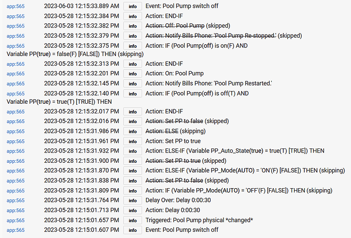

Thanks for the additional info. However, the device event specifically states it triggered the PP_Fix rule. I also, have all logging options enabled for the rule (Events, Triggers, Actions). The log snippet shows no execution entries for the rule. Previous trigger and execution had full logging for the execution. Hence, it still looks like the rule was triggered, but never actually executed.

Thanks again. I do understand what you are saying. The previous trigger that did log looks the same in the device events:
In the log they are the same:
But in the PP_Fix rule logs it does show the previous successful execution triggered as physical.
However, the preceding event description (on 5/28) is identical to the one on 6/3.
It appears the Hub has stopped appending the "physical" description to the On/Off event logs?
Although the device event log for both events notes it as digital?

bravenel - thanks for the clarification, but figured that was the case. Just from the logging it does not appear to consistent. This log entry is tagged as "physical", but the rule did not execute.
However, it is also labeled as being on the parent device, which is probably why the rule did not run.
