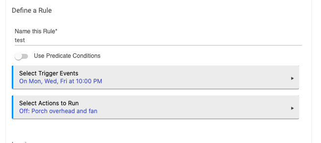

I think it would be easier just to create two rules with a periodic schedule and not bother with the predicate conditions... something like this:
Screen Shot 2021-09-06 at 8.05.46 AM
tried the event. When I uncheck certain days (Not to use) and update the days all become checked again. If I uncheck certain days and just go to time (without update), all days recheck.

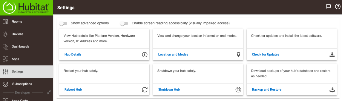

You don't by any chance have this set on do you? I had mine turned on accidentally and it didn't work so well :slight_smile:
Screen Shot 2021-09-06 at 8.58.37 AM
I'm not sure. Where is the SET located?
Click on settings and it is at the top. It's a long shot but it's easy to check and change if needed.
Sorry I can't find it in settings
It's ok. That probably isn't the issue anyway. You would notice it in a lot more places. Here's my screen shot just in case you want to keep poking. BTW what hub version are you on?
