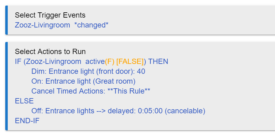

Here is a RM4 rule demonstrating how to handle multiple activity event during the timeout period. Each event resets the time out so the lights stay until there is no activity for 5 minutes.
As mentioned earlier Motion lighting is a good fit your case. I assume Motion Lighting code is faster than RM4 code. I have no idea if that is true.
