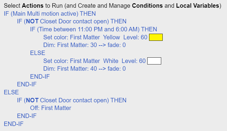

I am able to change the color via voice through my alexa device or manually. So it seems isolated to Rule Machine operation. Here's the action.

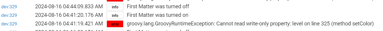

Okay, so I'm now getting an error on this device that seems to indicate it cannot read a write-only property. Again, this has been working for many months, so something seems to have changed.

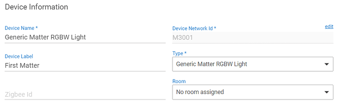

What device (brand and model) is that, and what driver is it using? And can you break it if you try the "Set Color" command from the device detail page, too? The rule seems to unlikely to be causing this driver error.
It's a Wiz Matter compatible bulb. Setting color from the device page works fine. I just set it to yellow and it had no issue.
The key point here is that it's been working fine until recently. I also find it interesting that the Groovy error mentions it cannot read a write only property (method SetColor).
My thinking is that this error is coming from Matter and that you'd be able to reproduce the same problem if you try the "right" thing with the setColor() command yourself. I suppose it could also be setLevel() with the transition time in your rule (though that's not what the error suggests) -- but either is all the rule would be doing, working through the driver in the same way you can test yourself.

Also, your rule is a bit odd. You are setting color and level, then immediately setting a new level with no transition time. While likely not related to your problem, is there a reason you don't just set the level you want as part of "Set Color" instead of something else first?
It's been a while since I created that rule, but if my memory serves me correct, that bulb wasn't setting the value properly within that command, so I added the extra DIM command. This weekend I'll remove it to see if that is a correct statement.
