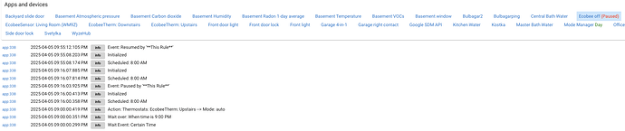

Thanks for the recommendation! Still looks broken though. I first paused, but then after reading your recommendation decided to resume and (re)stop. Now the app is stopped in the list of the rule machine apps, but marked paused in the log.
Screenshot 2025-04-05 at 9.57.14 PM
Hm, I guess the log entry really reflects the state during which the log entries got created and there is no log entry for stop. So, I guess all is ok, just weird looking :slight_smile:
Yes, if you're looking at Past Logs, the name will not necessarily be the current name. You'd need to look at the Apps list or the "inside" of the Rule itself.

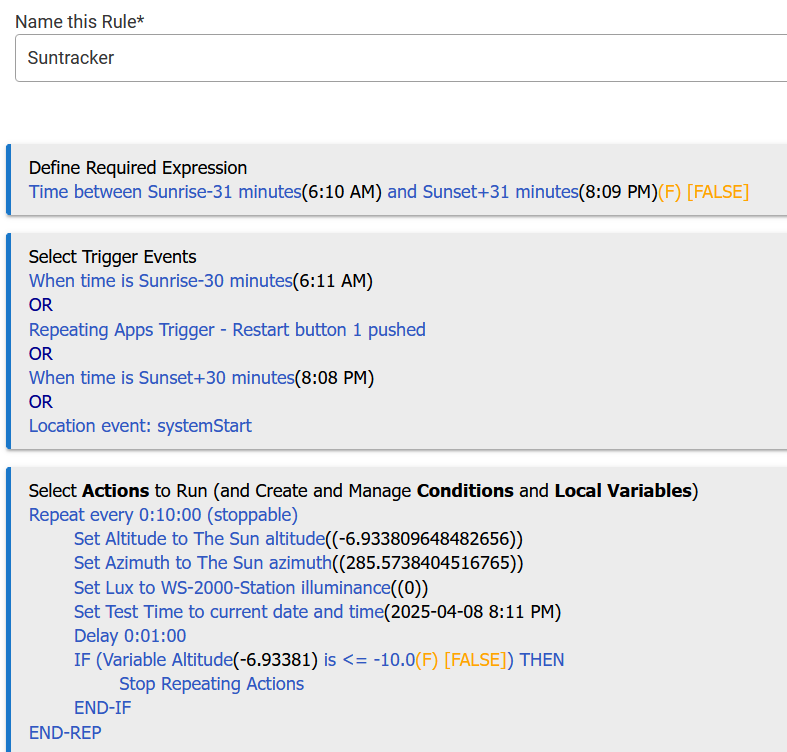

Fix for this released: Release 2.4.1 Available - #7 by bcopeland
Would this bug explain why this rule would not continue repeating today?
No, nothing to do with that.
