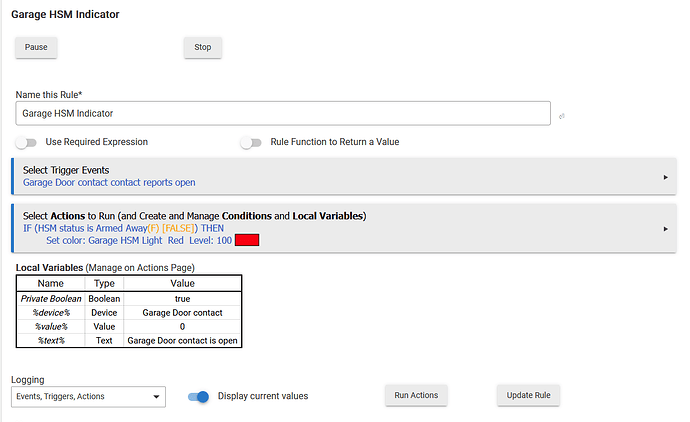

I have written a very simple rule in Rule machine to warn everyone HSM is "Armed Away" when the garage door opens.
I would like the rule to turn off the light when the HSM mode changes from "Armed Away" or when the garage door contact is closed.
Any help is very appreciated. Thanks in advance.
Unless I misunderstand the issue, wouldn't it be something like...
Trigger
   Garage Door is open
OR
   HSM mode changes to "Armed"
Action
   Set color RED

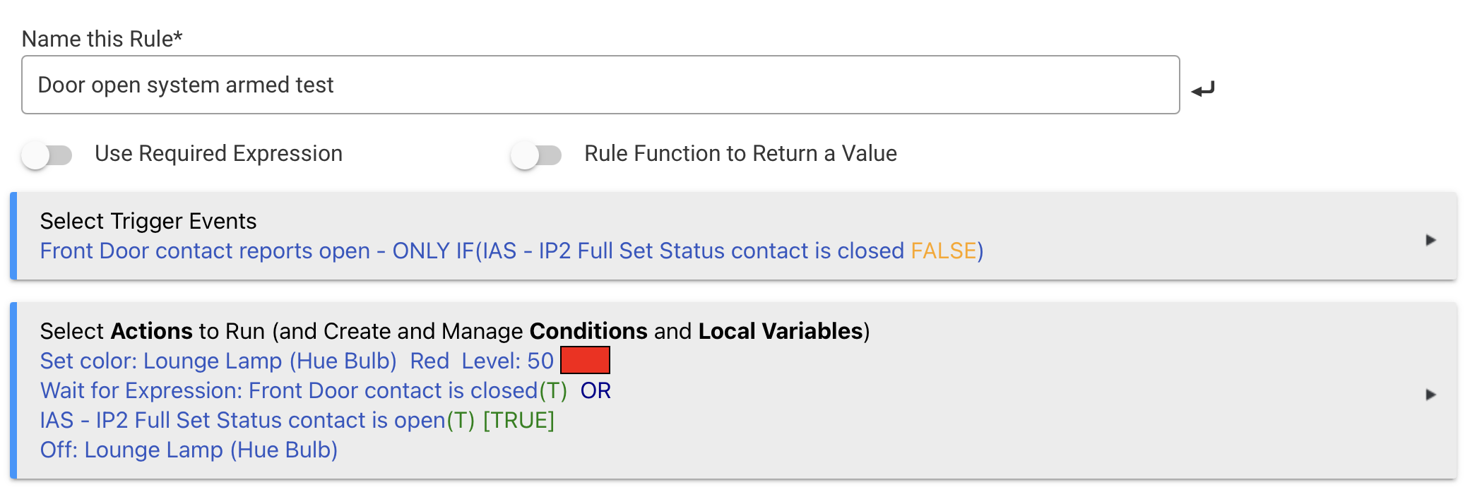

There are always different ways to do the same thing in Rule Machine so you'll probably get a few differing suggestions. I'd have done the bit you've shown differently. rather than using a conditional (IF THEN) in the actions, I'd have made a conditional trigger:
  • 'Garage Door contact reports open only if HSM armed Away'
I don't use HSM but I assume that option is available....
Here is an example where I've used my Front Door as the trigger, my Lounge Hue Lamp as the device and the status of my alarm system:
PS: If you decide to keep using your IF/THEN conditional rather than a conditional trigger (which is fine to do), be sure to add the 'END IF' after your actions unless it's a simple conditional.

Thank you all for the help :slight_smile: A conditonal trgger was what I needed :slight_smile:
